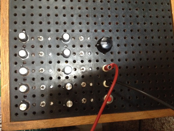

Here follows my device for the challenge as proposed in this thread: http://electro-music.com/forum/topic-47752.html&postorder=asc
It is a drum machine using only CMOS chips that i recieved in my electronic goldmine package. It's been a while coming. I started work a few weeks ago, and it is mostly done, with a few bugs to be ironed out. I am quite proud of it.

the list of modules:
Sequencer Panel:
1x clock generator.
this module uses a momentary push button into a flip flop to start/stop the clock using a 4001. along with clock output there is a start/stop gate and a reset trigger triggered at the rising edge of the start gate. for the clock oscillator i used a 4503 hex buffer. note that this is not inverting. I managed to get it to oscillate though, with repeated results. the manufacturer is motorola. schematic here:
1x swing generator.
a swung clock is outputted at 1/4 the speed of the input clock. there are 5 values to be chosen via a rotary switch. I believe the values are 25%, 37.5%, 50%, 62.5% and 75%. reset in, clock in, and swung clock out.
2x 2-in AND gate.
Nothing special here. I used a 4073 for this and tied two of the inputs together on each.
1x 6-bit 4040 binary counter
This is a basic module. whats annoying about the 4040 is that its asynchronous. so some of the outputs are inverted and the clock needs to be inverted on the input. clock in, reset in, /2, /4, /8, /16, /32, /64 outs.
1x 4022 8-step seq.
very easy and nice. the 4022 is an 8-step (octal counter) version of the 4017 (decade counter). the clock is sent to the 4022 and to an AND gate. for the AND gate i made one out of the 4503 and a diode per input. The AND gate gates the full length gates from the 4022 with the clock input to provide trigger outs. clock in, reset in, 8 steps, trigger sequence out.
1x 4512/4040 8-step seq.
this proved to be more difficult than I had planned. clock input inverted to 4040 to provide the stepping for the 4512. the output of the 4512 is gated in the same manner as the 4022 sequencer. same inputs and outputs as the 4022 as well.
1x 4052/4040 dual 4-step seq.
the 4052 is a dual 4-channel multiplexer, so i used it as a dual 4-step sequencer. made the same way as the 4512/4040 seq.
4x 4503 gate to trigger converters.
simple gate to trigger converter using the 4503 buffer. the input is differentiated and inputted to a 4503 buffer, straight output.
2x 4503 pulse stretchers.
pulse stretcher using a decay envelope into a 4503 buffer, simple stuff.
Voice Panel:
2x Metal percussion.
using the same 4503 oscillators as the clock. 2 oscillators AND'd together with a simple decay envelope into a diode vca. The oscillators are tuned with one pot. +V into pin 2 of the pot, pin 1 to osc 1's vactrol, pin 3 to osc 2's vactrol a simple and effective way of tuning two non-critical frequencies with one control. i use this idea often to control oscs. tune/spread knob, and decay knob. trigger input, and sound output.
this simple voice provides a decent hihat or chime like percussion.
2x Twin-t drum
using a 4011 i fashioned two ringing filter drums using twin t configurations. really simple and nice sounding. trigger input, sound output. pitch control and decay control. can also be used as a resonant bandpass filter.
2x Twin-t synth drum
same as the normal twin-t, using the same 4011, the difference being a pitch bend envelope. each drum has a different range, one for bass and one for snare type sounds. I couldn't make a noise source, as i didnt want to use transistors so the pitch bend helps a bit to have a snare type sound with a 'snappy' attack. schematic can be found here:
1x 5-input mixer
using a 4069 i made a 5 channel mixer, very simple, the schematic for one channel can be found in sketch3.jpg. the mixer can be overdriven nicely. each channel is then summed into a master channel identical to the input channels.
Now for some pictures!
my layout plan for the sequencer panel
the voice circuit board:
the voice panel inside:
the sequencer boards:
all three seq boards together with the panel:
the whole unit (with dog toy, very important to the sound):
the bottom is the sequencer and the top is the voice panel.

| JingleJoe wrote: | The whole device looks fantastic and it sounds great! The rhythm has me tapping my foot I'm really interested in that twin T filter synth drum though, can we get some more explanation of that? |
sure.
its just a basic twin t circuit adapted for use with a cmos inverter.
twin-t's when used with negative feedback are bandpass filters with very high q. when the filter network is sent a pulse it will 'ring'. the amount of resonance will determine how long the circuit will ring for, right up to self oscillation.
there is a lot more information available on twin-t filters if you do a google search.
i think they are really good at simulating drums, and a lot of circuit designers thought the same. they are used in old organ drum machines, right up to the tr-808 and similar analog machines of that era. |

Am I correct to think that the network of diodes and things before the twin T section is to generate a pulse to trigger the filter oscillation? |
No, not quite. those components are to create a variable decay envelope and a simple voltage control method as well as to trigger the drum. The two diodes to ground vary in resistance depending on thecurrent present at them. On my drum machine I already provide triggers at the input of the drums. If you don't want the pitch bend envelope you can eliminate those components. |
