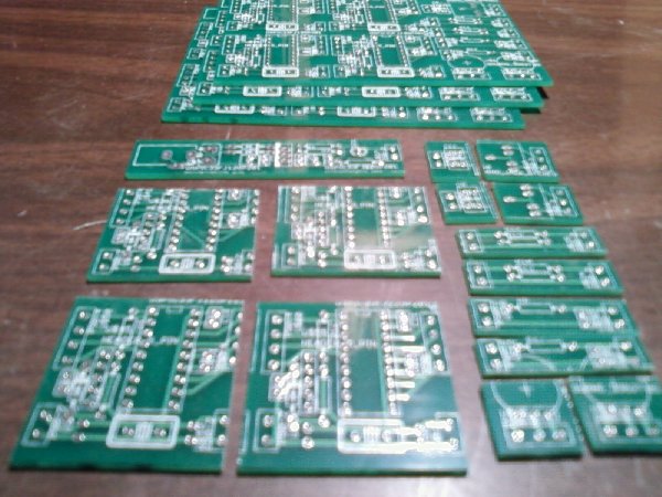

I've been thinking of making a synthesizer, kind of like a modular synth but made of little bitty circuit boards connected by wires. It's kind of like the dual form (i.e. duality) of a classic modular synth becuase the modules are not fixed in place but rather arranged geometrically. I posted about the concept and got positive responses mostly saying "go for it".
Then tonight it occurred to me that one could implement ChucK in this way. Lots of the UGens in ChucK patches are based on simple circuits anyway, so ChucK sort of lends itself to this sort of thing. One can imagine a gain block that is simply a difference amplifier with multiple inputs on both the positive and negative inputs. It would need a power module and adc and dac modules to get started. In fact, those three modules would get the thing rolling right away - a microphone adc and speaker dac with a 9V DC power module regulated down to +5V as is the style with guitar pedals. Or perhaps a dual supply of +/-5V would be best.
At any rate, I can begin plans for this by sketching it out on a web page. Comments welcome.

the first board is ready, it is a 9V in, 5V out power board. The Eagle design files for it are here:
http://www.freedomodds.com/music/eagle/echuck/Power.brd
and here:
http://www.freedomodds.com/music/eagle/echuck/Power.sch
I'd appreciate any comments.

The first panel of EChucK modules is designed and routed. I will be sending it out to a board house in a few days, and will receive boards eight days after that. So in less than two weeks the first EChucK boards will be available for sale and testing!

The big problem right now is, I had some boards made and the manufacturer did not even do the routing that I paid for. Routing is expensive because it chews up router bits, and making one board with ten *different* little boards on it is totally out of the question. I would have to make ten board designs, each tiled up with a separate EChucK circuit board.
That is possible, but outside of my budget for right now, so EChucK will have to wait until I can afford to get back into it. In the future, however, I do hope to make EChucK a reality. I apologize for any let-down that may cause.
If anyone wants to pick up the EChucK torch and carry it, I'm all for that as well! I can send the existing boards to such a volunteer for experimenting. Cheers!

I finally figured out how to chop up the EChucK boards. I had the solution all these months but didn't think of it. I just put my Dremel tool in a drill stand and put a diamond cutting wheel in it. By carefully adjusting the height of the cutter, I sort of rigged up a makeshift table saw of sorts. Just the thing for cutting the boards. Though, as you can see some of the little EChucK boards are trimmed a bit too close. They are still usable though.
I also downloaded and installed the MPLAB IDE and C programming libraries, then after days of reading pdf files and going through tutorials I was finally able to write my first EChucK program. All it does is output a square wave, but it is the basis of generating the PWM output signals that the modules will use to transmit audio.
I have been wondering about what to make as the first really useful EChucK programs, and just tonight it occurred to me that I could make guitar effects using the DSP engine in the dsPIC processors. That plus maybe an AM radio transmitter for guitar.
At the moment, it's all a moot point, however, because I have no programmer and no chips to program. In time I will get those things set up also. Little by little EChucK is becoming a reality!
EChucK boards, one of them chopped up!
