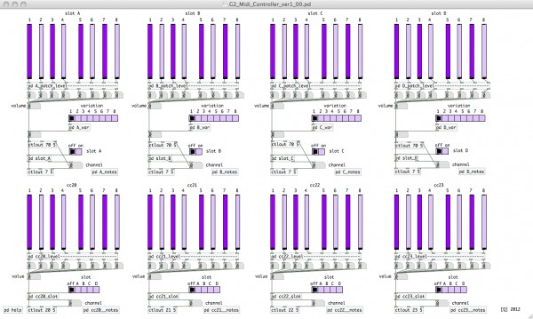

I do not know if this is of any use to anyone with a G2.
It is a Pd patch for controlling your G2 over midi.
It works fine with my setup.. a MacBook running OS X ver 10.5.8 and Pd-0.42.5-extended.
To use the patch you will need Pd-0.42.5-extended installed on your computer. All you have to do is unzip the file and double click the file G2_Midi_Controller_ver1_00.pd . At the bottom of the screen on the left hand side is a box marked pd help , if you click it you will find some hints on how to set it up.
My G2 has keys but I don't see why it should not work with a G2 engine.

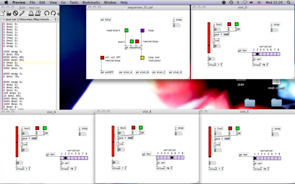

This is a Pd patch which is a simple sequencer for the G2.
The sequencer uses the Pd object qlist which reads the test.txt file which contains time-tagged Pd messages.
The sequencer is able to control the G2's patch level and variation selection for each slot.
I have included four simple G2 patches and a text file as a demo.
If you unzip and click on the sequencer_01.pd file, then click on the pd help box you will find an attempt to explain the text commands.
