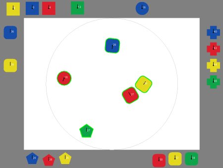

I'm trying to implement the reactivision TUIO/OSC receiver for ChucK.
Reactivision is the open-source software behind reactable. It runs a communication protocol based on OSC called TUIO (tangible user interface..., ). A "Tuio simulator" (java applet) helps debugging. This simulator is already a nice interface : each object can be rotated & moved and physics data are transmited through TUIO / OSC
reactable : http://mtg.upf.edu/reactable/
TUIO http://modin.yuri.at/publications/tuio_gw2005.pdf
TUIO simulator http://mtg.upf.edu/reactable/?software
To fully implement, the receiver must catch three different message : alive, set, and fseq. 'set' and 'fseq' are predefined formats but alive changes with how much objects are on the table. 'set' messages are the most important because they carry physics data (motion, position) and you can already have fun with it! (and the script below)

emoc wrote:
The script chuck below catch 'set' & 'fseq' messages, but to catch 'alive' messages, you'll need flexible pattern matching, if there's any way to do it with ChucK ???
A dirty hack & code nightmare could be to add as much osc receivers as objects on the table each trying to catch one more integer...
Hmmm, A good first step might be one OSC receiver that would parse OSC, then send ChucK events for the different shreds? That would at least save the OSC receivers. I'm not sure wether you can make a array of events but that would be a possible solution.... You could just make a array of those that's longer then the amount of blocks that you have and asign one to each shred as you start it. I don't think unused events have any real overhead that matters.

Thanks Kassen for your answer,
I don't know how to do this global receiver. So, I'll make as many OSC receivers as necessary to update a big array containing parameters from reactivision markers. Other shreds will get data there to do what they have to do!
