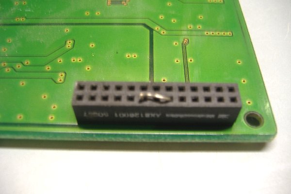

The infamous daughterboard connector that your interface circuitry needs to hook up with

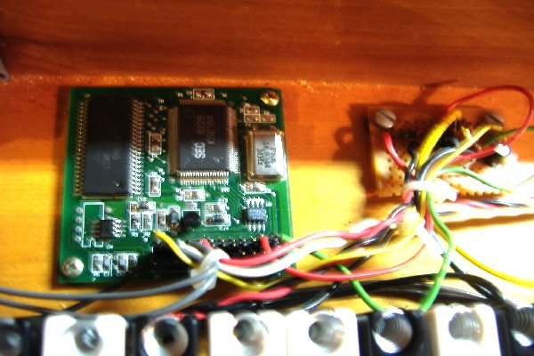

A cheapo $10 soundcard on the left with perfboard interface circuitry on the right built into my midi keyboard

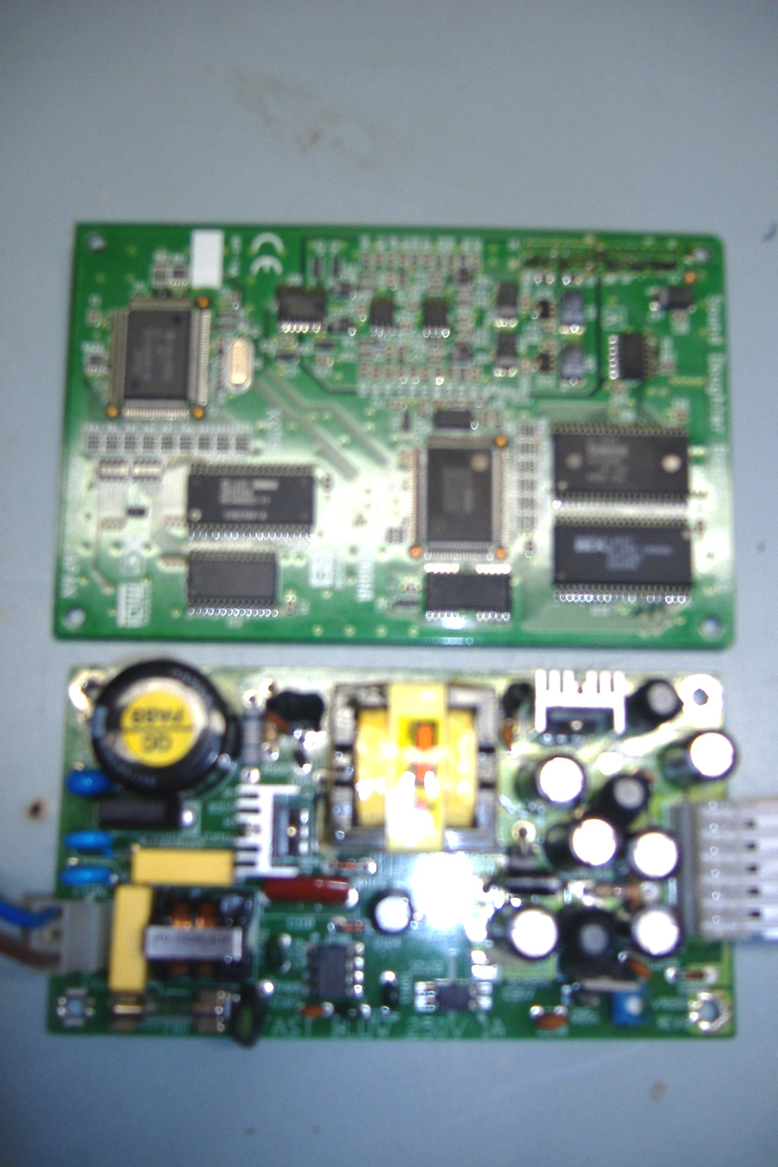

A top-of the line Yamaha soundcard (top) with a cheapo $10 open frame +/-12V, +5V switchmode power supply

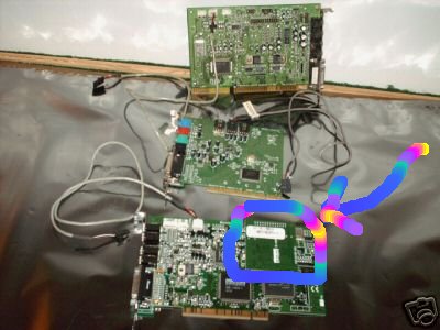

PostPosted: Wed Sep 05, 2007 11:27 am    Post subject: Reply with quote  Mark this post and the followings unread
Sometimes an eagle eye is required to spot a daughterboard on ebay (per the attached photo of a recent listing)
