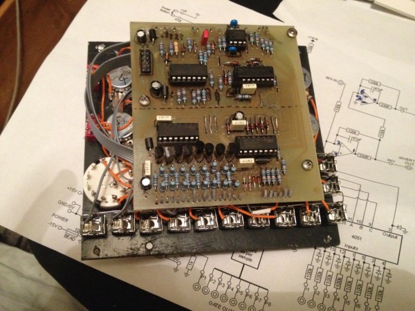

PostPosted: Sun Jan 12, 2014 3:36 am    Post subject: Reply with quote  Mark this post and the followings unread
i was bored one day and hacked his sequential switch from the component overlay image. Because i wanted it eurorack format i cut the pcb design in half.
What a great module thanks ken!!
