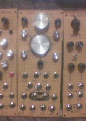

ive got one in cardboard, it has everything except the sub-osc. i had it with the sub-osc on a 3U panel but decided it could be condensed.
sorry for the bad picture
it is the one in the middle with the two big silver knobs
rolls like this,
big silver knobs - fine and coarse tune
small knobs at top - fm ac & dc with cv atten
small knob to the right of tune is pwm
small knob to the left of the tune is waveshape
small knob under tune is linear cv atten
jacks roll like this
pwm, fm ac, fmdc, Waveshape Cv
sync, linear cv, clk
sine, 1v/0, 1v/0, waveshape
pulse, saw+, saw, stair
our drill press broke otherwise i woud have made the plate for this by know
and ill find some nice ex-ham radio bakelite knobs for it too
those silver ones were just lying around

Nice!!
Now I know I am probably not thinking straight, but whats the advantage here to have both AC and DC FM inputs? |

im having a couple of stumbling blocks while trying to tune my cgs vco, i was wondering if there are some kids out there who have done this that can help me out.
ok so i disconnected my course and fine tune pots.
used the zero centre trim to pull voltage down to 0
then i grabbed 9v batter and scaled the current down to 1v with a pot.
i used a pot to do this and then ran the wiper and ground through a patch cable. first stumbling block. the voltage was measured at 1v without connection to the vco. (i had a dmm connected to the pot as well). Once i connected the patch the voltage dropped to 0.45V. It wasnt the pot turning by itself, as when i disconnected it, the voltage came back up to 1V. So im curious about this, do i need up up the voltage so it is 1V when it is connected? If someone could explain this for me it would be great.
so i assumed that i didnt need to re-scale the voltage and i tuned it roughly to a octave separation with the span trim. i used ableton's analog synth as a reference and did it by ear. i think i got it in there with only a few cents difference. i listened for a phasing effect and then tuned it a little more till it stopped and i got a unisen kinda sound.
anyway, so i didnt bother trying it for 3 octaves yet, i wanted to check what it was like, so i reconnected my tune pots and found that the range of the course pot was completely fuxed. The whole audio range was located in a degree or 2 of the pot. So this is obviously wrong.
this is the first VCo ive had to do this for (haha can you tell?? /noob)
where did i go wrong _________________ problemchild
melbourne australia
http://www.last.fm/user/prblmchild |
Joined: Apr 03, 2004 Posts: 24075 Location: The Netherlands, Enschede
Audio files: 277
Posted: Tue Aug 05, 2008 5:53 pm Post subject:
Luka wrote: | ido i need up up the voltage so it is 1V when it is connected? If someone could explain this for me it would be great.
Yes, up it, you'll want 1 V at the control input of the osc for an octave. When the pot is a high value one the 100 k load or so (typically) of the input will make the voltage drop. A drop of over 50% is a lot though, did you use a 1 Meg pot or something? If so the large drop would make sense, maybe better use something like a 1 k pot - it should still drop a bit then but far less - I'd still up it then ... if possible and measurable on the DVM. _________________ Jan
