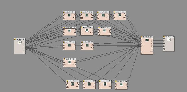

mosc wrote:
Ambiophonics Institute, I think I'm a member, if there is such a thing. Smile
Robin Miller built such a contraption in Audio Mulch with 15 delay sections. I help perform listening tests with this just about every week. The RACE algorithm came out of this. By adjusting the feedback control on a RACE processor, the attenuation of each successive reflection is increased.
Cool Excellent that you are able to have direct communication with him/them. I wasn't sure if there was an "official" institute but was referring more to whomever was working on the concept/ideas.

Hi again!
After the great results obtained by the mosc's ambiophonics plugin for stereo reproduction, I've been investigating about ambiophonics correction for a 5.1 setup.
The idea is to correct inter-speaker crosstalks by using several instances of the stereo crosstalk cancellation (i.e. the FL speaker interferes with the FR, CEN, SL and SR speaker; the FR speaker interferes with the FL, CEN, SL and SR speaker and so on).
In order to test this multichannel setup (in which speakers are located in an standard square-like manner), I've used a VST host (Console) and a Virtual Cable to redirect the output's media player to the host, insert several VST plugins and finally output the fully corrected signal through the sound card.
I attach the layout of the Console. Note that, for each speaker, four instances of the mosc's VST plugin are needed to individually correct its interaction against the other ones. In this way the signal is replicated (increased) four times and, in consequence, it should be significantly attenuated (-12db). Before the output you can see a multichannel convolver which models the individual IR responses of each speaker.
So far it worked. The multichannel scene is much more dense and covers the full 360º spectrum both form multichannel disks or movie soundtracks. However, it also sound a little fuzzy with the width parameter set to 10.
I am currently experimenting in individual crosstalks configurations as I assume that for example, the correction between the FL and CEN speakers (which are separated by a 20º angle) should be different from the correction between the FL and SR speakers (which conform a 180º angle between them).
The only parameter in the mosc's plugin is the Width, which suppose it controls the delay applied to the inverse signal, is it correct? The far the speakers are, the higher the value should be or is it the inverse? What do you think on this setup?
Thanks

Wow. That's great work. We have been thinking of similar things for 5.1 but haven't tried anything yet. I personally don't have a 5.1 set up that is suitable for such tight audio. My home theater setup is for casual TV watching.
I'm sorry to say that your post will take me a long time to digest and understand. I'm in the middle of the big WinterSteam 09 prep now. I will get back to this and post a better response.
The width control on this VST controls the mix between the straight signal and the delay/crosstalk side chain. Wide is probably vertical. No canceling if far left and just the canceling signal is far right. The delay is not adjustable. You are right that the delay should be increased a bit for wider angular separation.
You need a VST with adjustable delay. I have one I'm developing that will be for sale. It's not ready to post up on the store yet though. Lemme think about maybe putting it up on the store with a free-upgrade system. I have to consult my partner in this stuff first though.

Thanks mosc, this makes sense. Which width value do you recommend? With the maximum value it seems to me that the central image becomes too fuzzy, a value between 8 and 9 seems to work better. Do you think the mix value should depend on the relative speaker placement?
I have found another project (http://www.matrixhifi.org/drcop/docs/DRCoP_manual_es_v_0_7.html) which implements the RACE algorithm for crosstalk cancellation. It is in Spanish, but in the configuration window they provide a control to change the attenuation of the inverse signal to be added to the original one (which is similar to a mix control) and a delay control (in addition to a high and low pass filter).
The recommendations for setting those parameters are:
- To decrease the attenuation as the angle between the speakers increase (e.g. 2,3 db of attenuation for a 10-20º of separation and 5-6 db up to 60º).
-To increase the delay (measured in samples) as the angle increases to compensate the difference between the arrival of the original and inverse signals.
I will try to introduce delays for the mixed signals, even though it will complicate the layout quite a bit Twisted Evil. I'll be looking forward to updates in the new VST version. More configurable controls will be certainly very useful for fine tuning.
Again, thanks for making this incredible piece of software possible.
