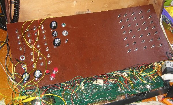

PostPosted: Fri Oct 10, 2008 2:56 pm    Post subject: Reply with quote  Mark this post and the followings unread
alrighty an update!
So heres a picture of the layout of the controls so far... patch bay on the right, switch bay on the left.
Patch bay is pretty standard for sk-1s, some other points in there buy mostly just connected to the fat 3 chips.
Switch bay is nifty, pretty standard.
3 red buttons below the switches are loopers, and effect loop time. All three can be used at once
The knobs right next to it are pitch and then a trem->rez->distortion knob
Then heres the cool part, i built up a 555 noise circuit and implimented it into the bend. It doesnt do more than feed noise into the circuit board, but it trips it out. Tweak knob, starve, and level. a switch to control whether the 555 is fed into the board or right to the speaker, which kinda causes a strange mixing effect with the normal out put, pretty cool.
+ LED. Then theres a patch point which is connected to the control voltage input of the 555 (pin 3 i think) which can be used with all the other points.
Rest of the space will be dedicated to what ever else i think up. I want to include an LED blink circuit to run a vactrol but experimenting with it last night didnt really bring much success. The home brewed vactrol works fine, but it seems to just not be in the right range of resistance to be usefull. Going to experiment with replacing the led with a Relay instead.
So far, so good, sounds Awesome!!
Oh, and as much as i regret it, everything thing was eye balled, so drill holes are not lined up at all, hilariously slick

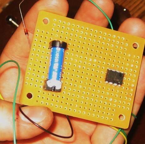

PostPosted: Sat Oct 11, 2008 9:36 pm    Post subject: Reply with quote  Mark this post and the followings unread
heres a picture of the relay circuit
Also, audio quality sounds great through my little roland microcube amp (100$ish great buy i highly suggest one) but when run through my recording set up sounds very distorted on the treble end. Wondering if this is a just an effect of the sk-1 not ran through the speaker cause the amp does some natural equalizing.
Also theres a high pitched quiet squeal through the line out which can be effected by the pitch bend that i cant get rid off. All my extra bends can be turned off so i dont think its a connection i made some where and am wondering if you sk-1 knowledgeable people out there might be having the same experience. Should i have grounded all my patch bay jacks or something?

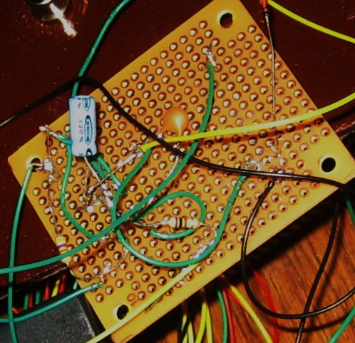

PostPosted: Fri Oct 24, 2008 11:09 pm    Post subject: Reply with quote  Mark this post and the followings unread
Ok, work on this has been slow... i wave building up a low pass filter for it but didnt have all the parts i needed. Upon getting the parts, building the filter, it sucked. Sounded awful.
So now im building up the WSG filter to use with it, hopefully things will turn out splendid. Heres a picture of the progress so far.
Added the LFO bend connectors (w/ off/on switch) and the usual patch to pot bends. Plus a switch that connects the line out or the internal speaker.
