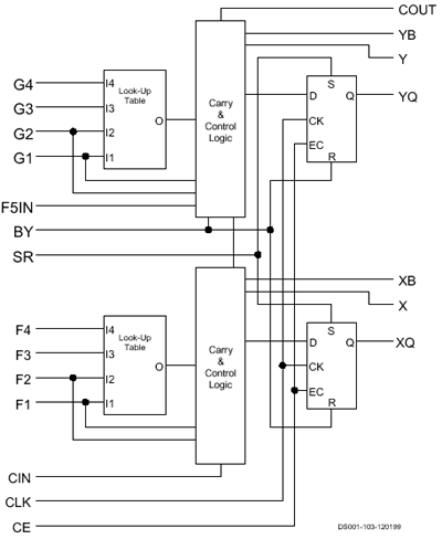

PostPosted: Sun Jan 13, 2008 7:26 pm    Post subject: Reply with quote  Mark this post and the followings unread
It's interesting how names of things morph depending on their use, the LUT is called simply a LUT when it's used as a complex logic function generator (in which case it is considered a ROM because the write line is not available to the design) or when referring to the internal primitive silicon construct, but when used as RAM, it's called "Distributed RAM".
Very interesting topic. Here is a excerpt an architectural description of the Spartan II FPGA which supports this statement:
From Xilinx Website:
Spartan-II function generators are implemented as 4-input look-up tables (LUTs). In addition to operating as a function generator, each LUT can provide a 16 x 1-bit synchronous RAM. The Spartan-II LUT can also provide a 16-bit shift register that is ideal for capturing high-speed or burst-mode data. This mode can also be used to store data in applications such as digital signal processing. The storage elements in the Spartan-II slice can be configured either as edge-triggered D-type flip-flops or as level-sensitive latches.
The block diagram is shown below this post.
So in the most generic of definitions:
LUT - Look Up Table - A fast memory by which a group of input signals, representing (x), may randomly index it's array, representing f(x), thus producing the transfer function of (x).
In computing, LUT's are used in place of computation of a trigonometric function because of of the very fact that the values are already pre-calculated for you so the table is just simply indexed and read. The trade off is more silicon is required. This is why a "Wavetable" synthesizer can have so many voices play at once, the functions are not calculated but simply are looked up. Much faster !!
So in the case of the "sine LUT", the inputs represent (x) or degrees expressed in radians so for a 256 entry table, it can be indexed in (Pi/256) radians. The sine amplitude is thus calculated via a fast LUT.
This may help settle on what definition we may give LUT ........ Very Happy Very Happy
Bill
