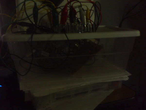

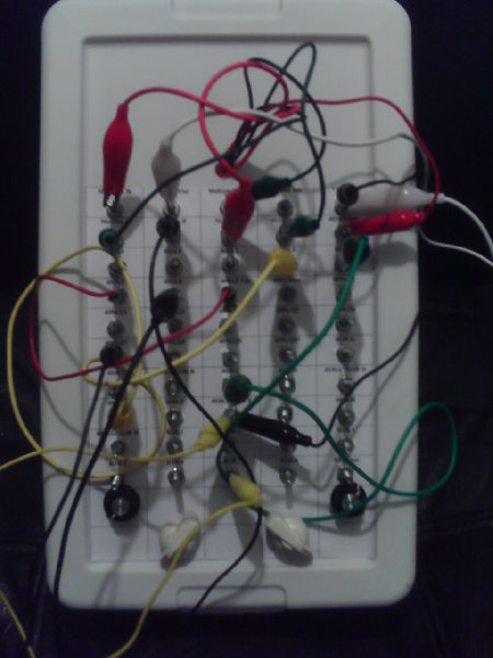

PostPosted: Tue May 19, 2009 11:55 am    Post subject: final product Reply with quote  Mark this post and the followings unread
Well yesterday I finally put the finishing touches on my 1st lunetta!! First off, recommendation to all noobs trying to do a bolt patch bay.. do NOT use a metal container that you drilled the holes in yourself =]] My final plan with the CDrom patchbay was to paint the thing after drilling (already done awhile ago for a failed circuit bend), then use electric tape on both sides of the holes (and even wrap the bottom of the bolt in thin plastic which doubles as a lock for the nut). This was SO much extra work to use a container I already had, which was NOT worth the extra couple hours (with only 50 bolts!!!).. Huge waste of time! Just go with plastic or a wood box!! I had spent a few hours putting the bolts in only to find out (surprise) that only 4/50 bolts were not grounded out by the box. So, I ran out to big lots and foudn a plastic Sterilite 6qt bin for $3.00 with a plastic lid. A little bigger than I wanted but it had plenty of room inside and for the front panel. And the big lots guy ended up only charging me $1.00 or so for it!!
So I bring it home, recharge my drill, then go into word and start a front panel cover. Awhile ago I picked up some full page labels from officemax for $10 or so, and with word I just made a table that was 5 cols x 12 rows as I had about 50 bolts and 4 pots. The thing turned out alright so I stuck it on and drilled my holes. (Note to self, next time use a template taped on for drilling, then line up the label with that after! But it came out fine though really..)
So my final setup for this rig was 3 40106 Var Clocks, 3 40106 fixed clocks, a 40106 vco, 4017->4051 melody generator, 4024 divider, 4094 shift reg, 4030 quad 2chan XOR, and an R2R ladder. I put a power switch on the left and the VCO output (1/4" out) on the right. The thing churns electrons and speaks in (electro)tounges!!!! I'm loving it, patching away with my small collection of alligator cables (only got 8 plus a piece of wire atm =).. I love the glitchy tones I get out of it!! I was up til 3am last night cranking out the glitch and experimenting with patches. Even with 5 basic (modules), you can get an endless amount of sounds!!! I'm loving every second of it =] I accidently recorded for an hour last night
The things I would change for the next one:
make CLOCKS that are more useful. Try to get a wide range. I would want better ranged ones such as LFOs .1-5hz, subs 10-100hz, midlow 100-1000hz, mid-high 1000-10khz, maybe 1 or 2 very high/noise 10k-100k. with all the chips in the world the thing is not gonna do what you want without the clock you want for that chip (for intentional patches @ least). I really was going for a talker/noodler (slower clocks .8hz or so i think is what you want for this which I don't really have without some patch-work). Clock speeds are VITAL!!!!
I didnt use an opamp in my R2R ladder, just used precision 1% resistors 499k/1m, and patched the output straight through. It works, but the Lower bytes in the ladder are VERY quiet. An opamp might fix this, or else an onboard CV based compressor would be nice.
My clocks have a little bleed, maybe you can get rid of this by stableizing a little more (not sure?), or in worst case scenario use a chip per clock (waste, I know, maybe not so bad for a 555..) ALSO add power starves to these =D
4040-4051 seq or 4017 Baby Seq to get the thing REALLY talking with control voltages. I thought the melody generator would really be playing some abstract sequences but (and this is just my bad clock problem) I couldn't regenerate what I had on the breadboard for some reason with the melody gen. I realized later I had used capacitors for my oscs that were off by a level of 10x. (.01uf instead of .1uf!!) so this is what caused my clock problem. So everything is working but its just way too fast. I have plenty of caps to fix it I just havent yet because I was excited to have the thing going finally and have been patching/playing.
I would add a VCF or pot driven filter of some kind, although the YAVCO VCO weight pot really works like a filter when low/feedback when high type of thing. REALLLLY recommend this YAVCO VCO, so simple, so useful!! And I would suggest putting at least 2 VCO's and a mixer onboard (stereo preferably), very useful for multitimbral stuff.
I want to add a patchable ribbon controller to this thing as well to 'play' around with some of the frequencies, I got a couple kits from Paia for $.33 apiece (MakeBlog offer) to DIY but haven't played with them yet as I've been consumed by this lunetta. You can do these cheap and easy, would be nice to be able to put in series with a clock pot or something.
I really like the bolts and think its the cheapest patchable setup you can get, and flexible!! I can stack alligator clips forever by pulling the plastic protectors up off them, for WAY cheaper than the price of stackable banana plugs/jacks (from what I've seen so far). This is way cool for a lunetta. I'll do at least one more lunetta like this before I start a modular project as my intro to DIY modular synths, as its so cheap, and looks cool too >=D Plus you can use solid core wire if you run out of cables Smile Another thing I noticed yesterday (unless this was coincedince) that when I moved my hand close (within 4 inches) of one of the cables, it affected the sound!! Really interesting. sometimes when you ground out the clocks too it affects the sound (i think this is the clock bleed problem)
I won't waste time labeling every lead on the board again, especially because labels don't like to stick to wire and half fell off anyway.
All in all I've spent 30-40 hours on this thing although more than half was spent researching ideas on the PC, downloading datasheets, and buying parts. Not too bad, could have done it in 24 hours easy if I had more experience or could just print out what I need, shut down the computer and GO. Soldering time was only about 4-5 hours really. I used one solder tip and nearly 100ft of solid core wire though! But parts wise the whole thing cost about $40 or less, and this is considering where I bought some stuff online (shipping) and @ radio shack, if you go with the cheapest source for everything, maybe $25 =]
Here are a few pics of this thing and a couple sound clips. All in all this has been a great experience, I've had a lot of fun, and got a lot of great ideas in the process!! I would rate this project as 10/10 even for electronics noobs. It doesn't get much simpler than this folks, great beginner project, cool to hear what logic 'sounds like', and great fun for audio tweakers to get some interesting tones/textures/patterns =D
Thanks to everyone on here for your help, input, suggestions, and Most of all, for keeping this idea alive and growing!!!!!!!!!!!!!!!!!!!!!!!!!!!!!!!!!!!!!!11111one1high
Lunetta in its new home, much happier.
 Filesize:  295.42 KB
 Viewed:  109 Time(s)
patched up lunetta, this one was so cool i had to take a picture to remember it.
 Filesize:  330.97 KB
 Viewed:  100 Time(s)
my baby from the side, yeah I should probably mount the board somehow but its fine really. I duct taped the 9v to the other side of the box =d And the sad thing is I have 9v clips just really couldn't wait to play with it some more =]
 Filesize:  325.85 KB
 Viewed:  96 Time(s)

That looks and sounds really great, nice work Smile
I like the bolt idea, you're right about the price of banana stuff, the cables and sockets are by far the most expensive part of my Lunetta.

amplex Exclamation
Awesome post - thanks for sharing your experience. I don't know that anyone could read that and not get enthused about a Lunetta project Laughing
You are getting some good sounds. I know how easy it is to get caught up patching and loosing track of time...these things will do that to you.
You mentioned some interaction between clocks - yea, I get some of that also. You can probably get rid of some of it by throwing bypass caps at it. I did that on a couple circuits, but eventually just decided to call it free bonus modulation and live with it.
In one of his first posts, mosc mentions grounding patch cords to the front of his machine. I have had some great success with that, and have gotten some wild sounds by just grabbing the patch cord end.
You might consider putting a small grounded plate on the front, or maybe adding just a 'patch-bolt' that is grounded.
Starve pots will do strange and wonderful things - explore that!
Anyway - great job. It's looking and sounding great and you have a unique instrument. I look forward to hearing more from you!

Awesome, great job! Smile
I like the bolt idea also, might try that on my next one, even less expensive than the bullet quick connectors.
Keep an eye out for packs of aligator clip leads on the auction sites, found a guy here that sells packs of 10 pretty cheap, I use them too for Lunetta patching.
Solid core wire is awesome too.

amplex:
great work and super write up! It's got me champing at the bit for my exams to finish on Friday so I finally can get my Lunetta boxed up.
all:
as a matter of interest I'd like to ask about boxes and rf/emi etc in Lunetta land. amplex has used a plastic box by the looks of it, I know someone else (DGtom?) is using perspex for panels. Do you think there is a risk of radio interference etc? I ask because WizardMike recommended in another thread that if I'm going to use perspex then everything must be grounded. But Lunetta front panel stuff doesn't use a ground (hence the abundance of bananas!). Currently my stripboard circuits all seem to function fine without unwanted interference without any box, but I've not tried it close to computer/TV/fridge/pylons yet Smile
Do you think I can get away with a plastic or wooden box, using bolts ala amplex with ground for the circuits coming from the PSU? (i.e. +9v and ground)?
David
RF
Joined: Mar 23, 2007
Posts: 1481
Audio files: 28
PostPosted: Wed May 20, 2009 5:29 am    Post subject: Reply with quote  Mark this post and the followings unread
I would expect you'll be just fine unless you are living next door to a high powered broadcast station. The CMOS voltage levels are a several orders of magnitude above what you are likely to see from RFI.
I suppose an exception to that might be if you include any fairly high gain audio amplifiers in your device. Even then, with common sense grounding and bypassing - you shouldn't have any problems.
I look forward to seeing and hearing the fruit of your labor!
