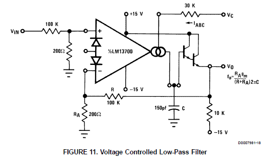

Hey Les, I was just looking at the LM13700 datasheet, they have exactly the kind of filter you need, a single pole lowpass. This should closely emulate the normal single pole IIR filter one would use in the digital domain. See attached image.
Note that the control current is done in this schematic with a resistor and a voltage feed. This works, but is _crappy_. What you want is to remove the resistor and supply a current source (either linear or expo) to feed the Iabc (control current) pin.
I know _nothing_ about expo current sources, so I can't help with that, but I've done linear current sources interfacing with LM13600/LM13700. What you need to be mindful of is that Iabc must be absolutely restricted to no more than 2ma - or chip death results. That isn't terribly hard to manage though. There should be members on this forum who can help with that bit. I wouldn't think a filter like this would need temperature compensation assuming you want to do an expo source.
You may or may not need an opamp stage after the filter to give the correct gain for the K-S loop. The buffer (darlington) will be only a voltage gain of 0.999999. If you need more gain, you'll need that opamp stage.
EDIT ADD: The schematic came from a National Semiconductor datasheet.
EDIT ADD: I will want to hear sound samples of this assuming you do it all on your board (which I would suggest).

On second thought, I see no need for any kind of calibration of the CV to the filter. In that case, it would be easy to keep the 30K resistor shown in the schematic and supply a control voltage stiffened by an opamp buffer. 30K was chosen because the span between -rail and +rail is 30 volts. Doing it this way, you will eliminate the complications and parts count of a current source.
Connect the output of an opamp buffer to the 30K resistor. The CV can go from -rail to +rail. At -rail, the Iabc current is essentially zero. This will change the character of the loop and affect the sound, but it doesn't need calibration or tuning. The lower the CV, the more drumlike the sound would be and the faster it would decay.

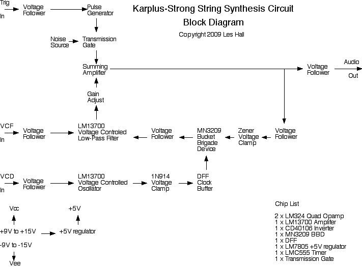

Thanks wmonk, I took a look at the Sound Lab VCF. It looks like a fully customized design for the task, which is nice for that product. Of course we cannot duplicate the circuit or even use part of it, but that's OK since the LM13700 datasheet has such excellent circuit examples.
Attached you will see a block diagram of the circuit that I just put together a moment ago. Please have a look at it and offer any design suggestions that you may have. This circuit will barely fit on a 3"x4" circuit board (the Eagle CAD limit), if it fits at all, but it is packed with features.
Note that we can bias up the VCF and VCD inputs so that if you don't hook up a control voltage, you can just use pots to adjust the filter and delay characteristics. There's another pot for loop gain, and a trigger input. The noise source is fixed, but we can add a bypass to permit any desired signal to be used as the noise burst, which will shape the sound.
I like the way this board is shaping up.

Looks good to my eyes.
Just curious here - in my digital experiments with KS, I used an impulse to excite the waveguide and got what I would call a struck string sound (similar to a hammer dulcimer). I understand that the classic KS demonstration does, as you have, use noise. I'm wondering if using a straight impulse as an optional excitation source would be good? In my implementation, the impulse was calculated to be a proportion of the waveguide length with 1/2 being bassier than lesser proportions.
Time flies like a banana.
It would be nice to have options on the exciter I think, that is, in my experiments with the G2 it was nice to try different stuff ... f.i. a steady signal fed in is fun for resonator type of effects ... an attenuater would be in place then BTW to make sure the KS won't clip.

Yeah, like what Blue Hell said. Cool
I think a socket for trigger pulse directly into the BBD would be good so that you can do whatever, square, tri, saw, single cycle sine, whatever ya plug in. Normalize it for noise.
