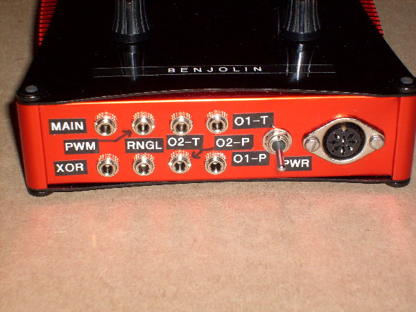

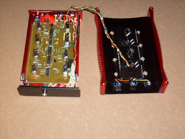

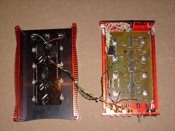

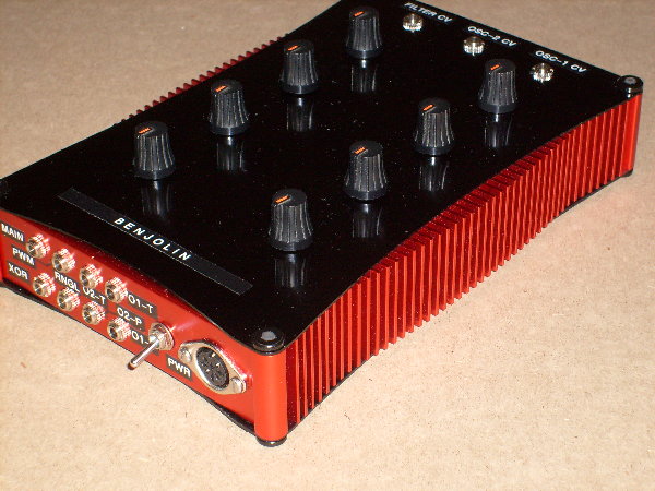

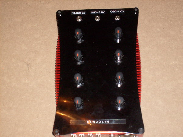

Here is my Completed case for the Benjolin.
I agree that sockets would have been greatly appreciated. The PCB was very high quality for a home etched unit. Kudos to Rob and Joker for the workshop.

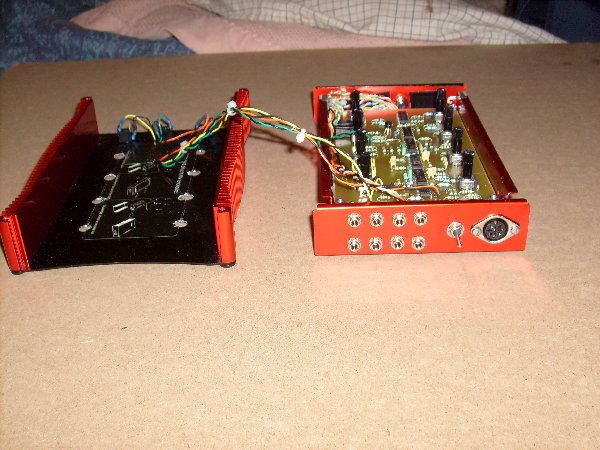

PostPosted: Tue Nov 03, 2009 12:01 pm    Post subject: Reply with quote  Mark this post and the followings unread
A couple more...

Here's the labels for the knobs.
 Filesize:  1.76 MB
 Viewed:  478 Time(s)

Wow, that is nice work, you were right about the case Cool
Posts: 2797
PostPosted: Tue Nov 03, 2009 4:06 pm    Post subject: Reply with quote  Mark this post and the followings unread
Holy cow Dan !!! That is really beautiful. I love it. Looks like a hard drive enclosure. Nice idea !! Now you have no excuse not to jam at EM 2010 Wink

Whoa Danno, you're fast, we built this board last saterday.
Anyway, labeling seems a good idea, I scribbled the names on my board with a marker for lfuture reference. Saves me from checking the schematic later.
(note: Dan's cicuitboard is mounted with the two headers on the left side)
Danno Gee Ray
Joined: Sep 25, 2005
Posts: 1349
Location: Telford, PA USA
PostPosted: Tue Nov 03, 2009 4:28 pm    Post subject: Reply with quote  Mark this post and the followings unread
Thanks,
Yes it is a Hard Drive enclosure. The USB circuit in the enclosure had failed. Seemed just perfect use for the thing.
Worked on the case two days straight. I rather like it.

Just figured out that in my haste, I put the knob labels on incorrectly. I've replaced the photo. Sorry for the fuzzy image.

So, lables according to Dan:
Benjolin circuitboard with the knobs labeled
 Filesize:  59 KB
 Viewed:  518 Time(s)
Danno Gee Ray
Posts: 1349
PostPosted: Tue Nov 03, 2009 6:35 pm    Post subject: Reply with quote  Mark this post and the followings unread
Yes, see this link for verification:
http://web.me.com/klangbureau/DIY/making_of.html
