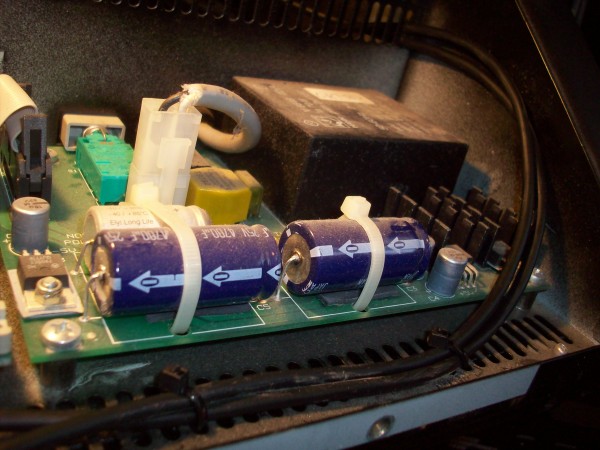

PostPosted: Sun Dec 30, 2012 3:53 pm    Post subject: nord modular c/v out Reply with quote  Mark this post and the followings unread
OK I've been working on the c/v out plan, found some simple opamp circuits on howtobuildarobot.com web site. I was about to order some parts then thought I would check output voltage again and I was able to get 4.78v. I headed to Radio Shack to pick up a couple 1/8" cables with stripped ends and 1/4th watt 470 ohm resistors. The varice mod only took about a half hour. I tried playing the keyboard, not only was it not 1v/octave but the higher up I would play the lower the oscillator would go! The output voltage is inverted! That was a bit mind bending. Once I used the voltage inverter part of the InvLevShift module it sounded better. Maybe this is what 3phase was referring to when he wrote about the NM1 signal not being scalable or useable. I have gotten in the 4+ volt range by inserting an amplifier module and cabling the output to the same channel of 2 separate output modules. I haven't figured out what settings yield 1v/octave yet.
It is exciting being able to control my modular with all these nord virtual modules!
note: These are not instructions for someone to follow and blame me if they blow up something. Confused
Some pictures:
[img][/img]
Soldering to the small solder pad in front of the coupler capacitor was delicate. I tinned the end of the resistor wire with a little drop of solder.

Great work Nucleus, and thanks for the pictures!
Albert
