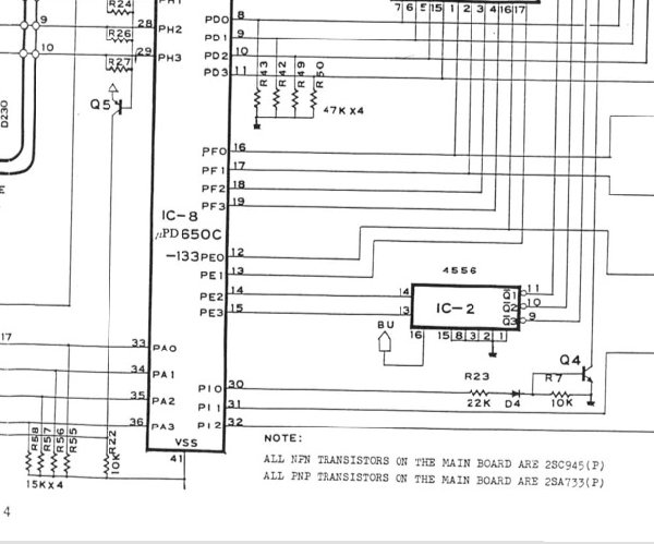

For the middle of the ladder, the x0xb0x kit, and almost every other reference I've seen calls for 2SC536F NPN transistors. However, I'm looking at a fairly complete TB-303 service manual dated Feb 19, 1982, which is the source of the TB-303 Main Board schematic often seen on the web. This copy I have though has the previous page as well, with the not often seen Switch Board/Digital Board schematic. At the bottom of this page is a note: All NPN transistors on the main board are 2SC945 (P), All PNP transistors on the main board are 2SA733 (P). Oddly enough, the parts layout diagram in the same edition of the manual makes no mention of the 2SC945P, but shows that 2SC536F is used. To add to the confusion, the very next page of the SAME manual contains the parts list. No mention is made of either the 2SC945 or the 2SC536! scratch In fact, the parts list makes no mention of a small-signal NPN at all!
If anyone has a real TB-303 and doesn't mind looking under the hood (or bonnet!), I'd like to know which NPN transistors are mounted. I have a few '945 and '536 transistors, but not enough of either to finish the ladder. I'm also tempted to not worry about either one, and lay the board out to use 2N3904 instead. I'm not sure if the sonic difference would be audible or not. If anyone has any experience with the sonic difference, if any, between the three transistors mentioned so far I'd appreciate the input.
I say "mentioned so far", because I ran into yet another source that claims the BC182 is the SAME transistor as the 2SC536F, the only difference being the European vs. Japanese part number. Can anyone verify this? It seems that BC182 is still available, and cheaply.
Attached is a closeup pic of the service manual notation I mentioned...

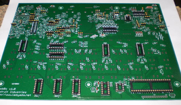

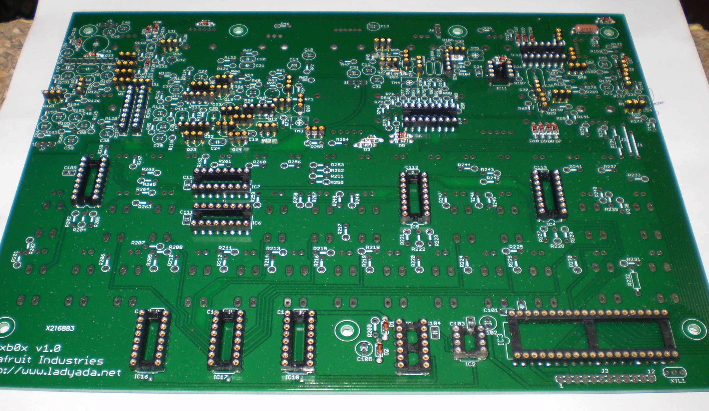

EDIT (10/15/2010): After digging around for data since I posted this question, it appears the answer to 2SC536F vs. 2SC945P is both. 536 in the earlier builds, 945 in the later builds. Since there has been much talk of the effect of different semiconductors on the sound of audio/synthesizer circuits, especially the TB-303 and clones I've decided to do my normal thing to find the answers: Build a circuit in such a way that various parts being evaluated can easily be changed.
I've ordered a x0xb0x motherboard and processor and begun building it out. I'm not sure I'll even build the sequencer section or not, as the main thing I'd like to get out of it is a fun little monosynth (with a cool sounding filter!) and a midi-to-CV converter. A pic is attached of the first stage of the build, with only the diodes installed, and a machined-pin socket installed in EVERY semiconductor location:
303 clone board w/sockets. Believe it or not, every socket on the board is salvaged from other dead equipment, or bulk purchased from surplus dealers.
