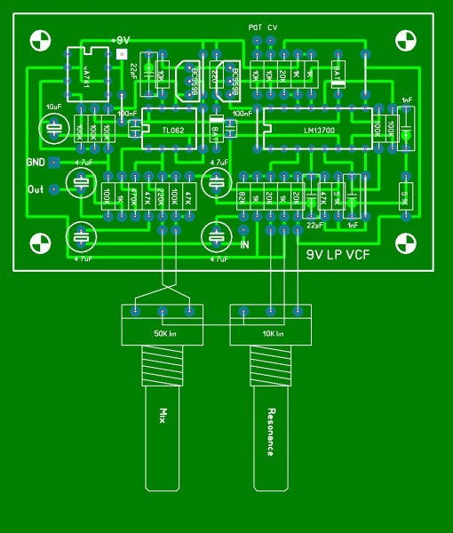

Posts: 3601
Audio files: 545
PostPosted: Sun Mar 11, 2012 9:30 am    Post subject: Reply with quote  Mark this post and the followings unread
I found the layout, but I'm not sure which file-format you prefer
but here's a gerber file with the layout
(you can use http://www.gerber-viewer.com/ to view and convert it)
and an image which shows the component placements.
I didn't use a TLE2426CLP but made a simple voltage follower with a ua741
(you can use a different opamp for it), I also increased the capacitor size in
the audio path. (from 2.2uF to 4.7uF). the frequency potentiometer is
connected to the pad marked pot (that makes sense I think) and there's an
extra pad for an external control voltage, I also added some protection
diodes (labeled BAT). use some schottky diodes for these like BAT85.

hey phobos thanks a lot!
that layout looks is for sure less scary than wiring on perfboard
i'll try to etch a board soon as possible

PostPosted: Sun Nov 17, 2013 11:14 am    Post subject: Reply with quote  Mark this post and the followings unread
Thanks to PHOBos,
I've etched his board layout (pcb made by techiguitare in France) and finished the soldering... first test and the filter works really well.
15€ for the board etching + 15€ for the components and you've got the best 30€ VCF out here Wink

My filter is now in box (pedal format) with cv input working great with home build sequencer Wink
But, i've noticed a significant volume decrease when the effect is engaged. Do you think it's normal with this kind of circuit and can i make some mods to resolve the problem?
Posts: 3601
Audio files: 545
PostPosted: Wed Jan 01, 2014 1:42 pm    Post subject: Reply with quote  Mark this post and the followings unread
hmm, well if you use a filter the ouput signal will be somewhat less then what it was, but that also depends on the source signal you use. I mean if it has a
lot of low frequencies than a LPF will have less of an effect then when it has a lot of high frequencies. However if the output is just generally lower you
could try to boost it by increasing the gain resister at the output stage (R21 = 100K).

PostPosted: Wed Jan 01, 2014 4:00 pm    Post subject: Reply with quote  Mark this post and the followings unread
It looks like I changed some values on my version. I usually do that if I find a circuit, breadboard it and then make adjustments to my liking. But had
forgotten that I did that with this circuit too. Embarassed I guess you build it with the values on the PCB.
R21 is the 470K resistor on my version, but I shall make a list to see what I replaced. (I wouldn't advice making that one larger btw).

PostPosted: Wed Jan 01, 2014 4:43 pm    Post subject: Reply with quote  Mark this post and the followings unread
you would have to make it larger but 470K is allready pretty large, it's possible though. (if you make it very large it will be more sensitive to noise)
I just took a look and the only values I changed are from the output mixer:
Code:
Rx    org.    mod.
R17 =  33k ->  47k
R18 =  10K -> 220k
R19 =  33K ->  47K
R20 =  10K -> 100K
R21 = 100K -> 470k
MIXPOT = 10k -> 50k
(I also added a 100K resistor to GND on the output to prevent pops when plugging in a cable)
So you could make R18 and R20 smaller. (you can find all those resistors between the 4.7uf capacitors)

I located the PDF and the filter I build so I will measure some voltages.
do you get any sound out when the mix pot is turned to the filter ?

the sound is coming out nicely but unfiltered....
