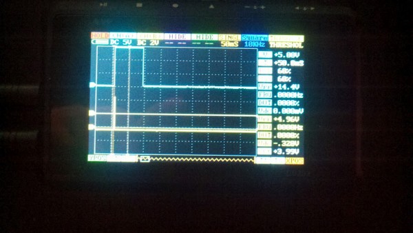

First: with just the input transistors hooked up, the trigger does generate the very fast pulse on the collector of Q1, and the value at the collector of Q2 basically follows the gate, except from 0 to 15V (gate is 0 to 5V).
Second, with the 555 and 4016 in place (can't really charge the timing cap without both), now the collector of Q2 is normally at 7.5 volts, not 15. Poking around, if I disconnect pin 12 of the 4016 (the release path) then I go back to the previous behavior. This is of concern because it doesn't drive pin 4 (reset) on the 555 correctly..
Even with pin 12 removed, however, I'm still seeing no pulse on the output of the 555. I suspect perhaps that my trigger pulse isn't wide enough. But without that output going high, I never charge the timing cap, and it all just sits there.

PostPosted: Sat May 05, 2012 10:36 pm    Post subject: Reply with quote  Mark this post and the followings unread
Amazing how much better a circuit works when you have power actually hooked to power instead of ground. Embarassed And aside from that goof, I really need to find a better way to get power onto my breadboards, the mta-100 connectors aren't staying in very well either.
I've only been observing the timing cap right now, I haven't yet hooked up the TL071, but I am definitely getting classic ADSR waveforms now.

PostPosted: Sun May 06, 2012 6:23 am    Post subject: Reply with quote  Mark this post and the followings unread
Aaaand with the op amp in place, measuring the actual output, looks very nice. I haven't tried twiddling the knobs any further, but just looking at it, the drop on release is 1/4 second now, so that appears to have likely resolved my concerns about timing. We'll see what I hear later....
