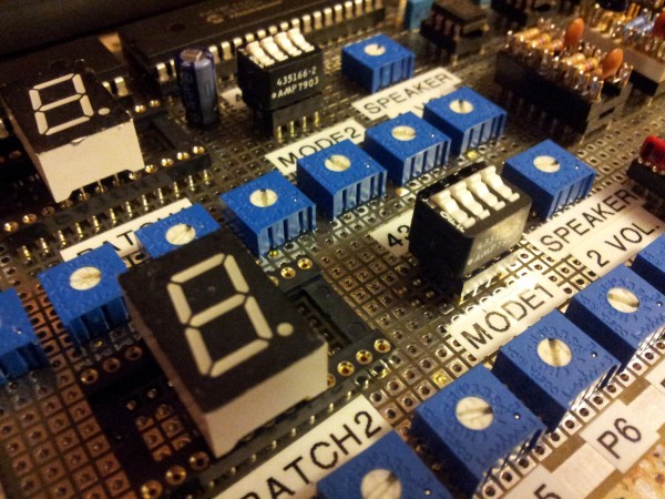

Here are a couple pictures of a dual Fractal Synthesizer on a vector board. The is will used as part of a DIY setup at this years electro-music 2012 electronic music festival. It will be a collaboration entitled "The Soldering Musician and the Personal Digital Assistants". The board contains the original speaker amplifier for stand alone operation when connected to speakers and also has an LM358 based , capacitive coupled, LINE amplifier/buffer to connect to an audio mixer.
The original dual version was on solderless breadboard and did not have the LINE amplifier. It appears earlier in this thread.
I particularly enjoy using the WSG and FM sequencer patches on this synthesizer. It's a fun synthesizer to play around with ! Cool
Next the PT delay chips shall be added.
Its been a LONG while since I revisited this but still have to purchase the CCS compiler to add patches.
Bill
