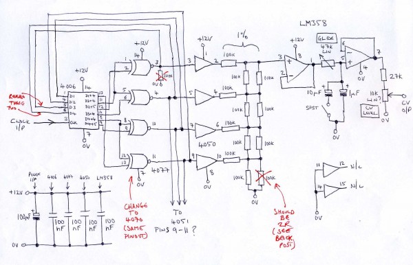

Thanks for the input Brock & Jingle Joe. You spotted my "deliberate" mistake Brock. That's what comes of trying to do something from memory with a heavy cold, I think. Of course, it should have been a 2R to 0V.
I have been fiddling around with the circuit a little (as I feel a bit lousy at the moment), but I still haven't found a 100% reliable solution to the problem. It does seem to be powering up in the steady state condition (everything's high on 4006, therefore the outputs on the 4077 are all high). I've tried a adding a pull-up and pull-down to the clock output (not at the same time!) but that hasn't solved it either. I'm using a 555 astable at present to clock it. Do you think that a CMOS oscillator (maybe a 40106 or a 4093 based oscillator) might make any difference? I may be grasping at straws here.
Thanks for your comments about the crappiness or otherwise of my VCO, JingleJoe. I have a habit of putting myself down all the time. I must get out of it!

A quick fix, not necessarily a good fix, is to add an inverter on one of the shift register inputs or outputs. This will get you past the power on steady state condition but doesn't mean you won't create another. Another option is add a series resistor on one of the inputs and a normally open switch to ground. When the SR gets to the all high steady state just press the switch and you'll be up and running again. Or you can design some fault detection logic that automatically toggles an input when steady state is detected. |

385 Hz is remarkably slow even for old 4000 series cmos. I wonder what's going on there? But even that rate is enough to go through a maximal sequence of (2^18) -1 at least 15 times so it probably isn't hitting a steady state condition at the higher rate. I wonder what the maximal length is of this shift register configuration?
Another solution to the powering up with all bits high is to swap the 4077 for a 4070. This will make the inputs to the 4006 all low.

I did wonder what would happen if I replaced the 4077 XNOR with a 4070 XOR. I'll try that as well (it's very straightforward as the pin-outs are the same). Also, I know of the problem of the 4006 becoming hard to obtain, so I did buy several before they become impossible to find. I wanted a spare anyway, since my old Transcendent 2000 uses one to produce pseudo-random white noise and you never know when it might give up the ghost. It also uses CA3080 OTAs which are obsolete now. I have a few of these spare.

Randomizer Success!!!! |
Hi Guys,
I think that I've finally got it to work properly. I tried several of the ideas, including replacing the 4077 XNOR with a 4070 XOR. This half worked, but the R/2R ladder was only producing 4 voltage levels instead of 16 (2^n and all that). I assumed (correctly) that this meant that there were identical waveforms being produced on the some of the outputs of the 4070 (in fact, pin 3 = pin 10 and pin 4 = pin 11).
At first, I starting to think about inverting the pin 10 and pin 11 outputs (making the circuit more complicated), but then I thought that I'd experiment with the 4006-4070 interconnections. My first attempt, was to reverse the connections to pin 5 and 6 of the 4006 (i.e. 4006 pin 5 to 4070 pin 4 and 4006 pin 6 to 4070 pin 3) and it worked straight away! It also no longer needed the pull down resistor on pin 3 of the 4070.
I have attached a revised schematic (well, one with some red pen on it anyway). I have also shown the correction to the R/2R ladder, spotted by Brock. I haven't put any new waveforms up, as they look virtually identical to the earlier ones.
Now, I can finally try it out with the sequencer and see how it sounds. I hope that it was worth all the effort.
Gary

Joined: Jan 15, 2011 Posts: 427 Location: Montreal, Canada
Posted: Wed Sep 26, 2012 6:48 pm Post subject:
I think you've got it, Gary! I made the changes you suggested and it appears to work fine. I crank the clock speed to about 1600Hz and it doesn't lock up, although it sortof becomes not-too-interesting, or at least it seems to barely change. But then maybe it's because the R/2R and VCO (which is what I'm testing with) can't follow the voltage changes that quickly? Anyway, I don't need to go near as high for what I use it for.
Truth be told about the pulldown res on the 4077's pin 3... after mentioning it, I discovered it didn't really solve the problem... I just never got around to updating the thread.
Now, if you want really fast bits there's the XOR chain or ring which can produce a kindof white noise cloud of bits when clocked fast. There was a schematic by ezekiel, but he may have posted it only over on deathlehem.
I shall update the schematic soon in the other thread. I'm going to do more tests... it seems to be a little too repetitious, but I'm not sure.
I tried to find a good way of resetting the pattern, but it's tricky... e.g. one can cut the power to either chip, and it still keeps going. Even cutting both chips, it sortof still runs! Alas, I ended up frying a precious 4006, and still don't have a good solution.
Thanks again for your work on it.
