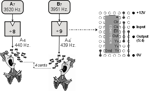

The Pythagorean or Just (meaning true) major tone is the frequency ratio of 9:8, which is 204 cents.
This is easily calculated by subtracting the Harmonic Logarithm of 8 from that of 9 (see page 4 of PDF, centre table).
Idea If we take the outputs of two tone-generators, nominally a whole-tone (200 cents) apart, divide the higher by 9 and the lower by 8, then the result will be two voices separated by a nominal 4 cents. We will have extracted the difference between the Just and the Equal-Temperament whole-tone. Razz
The beauty of this is that digital instruments are already awash with real or implied divide-by-8s; we don't need to add any more. We just need to add the modulo-9 divider.
(Don't fret, that's just a fanciful name for divide-by-9, and is dead easy to implement using a single CD4017 or HC163 )
Another plus is that the output from a modulo-9 divider is not naturally a square-wave and will therefore contain even harmonics.
The harmonic structure does not conform to that of the boring old staircase/ramp and so, even though it has joined the chorus, it will stand out from the crowd. Laughing
Fig.1: Simple implementation with duty-cycle of 55.5%
 Filesize:  55.96 KB
 Viewed:  4255 Time(s)

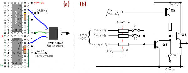

PostPosted: Thu Feb 07, 2013 4:13 pm    Post subject:  Waveform select
Subject description: Choosing the tone colour
If the link from pin 11 (Y9) to pin 15 (reset) is made with a resistor, then grounding pin 15 with a switch will revert the 4017 to its native divide-by-10 mode (because the reset is active-high).
By cascading two such ICs and selecting one of the two reset pins by a two-way switch to ground [Fig. (a)],
then the final output will switch between 50% (divide-by-10 mode) and 55.5% (divide-by-9 mode).
This will allow a rapid audio comparison of the tonal difference, the constant divide-by-90 avoiding any confusion caused by a change of pitch.
Furthermore, if the clock input is taken from pin 6 of a 74HC4060 running at 5.0688MHz, you will have a handy A4 = 440Hz reference ...
5.0688 MHz. = 440.0 Hz.
9 × 10 × 128
For a 110Hz reference (guitar 5th string), use 'HC4060 output pin 13 instead, and generate a 33.3% duty-cycle.
You can also tune 220Hz and 440Hz to this because of the 2nd and 4th harmonics. The absence of 3rd, 6th and 9th harmonics reduces confusion (see tables below).
Pin 12 ("Out") is active-high for the sum of time-slots Y0+Y1+Y2+Y3+Y4.
If the count is aborted at time-slot Y9 (via the reset link) then the active-high width of Out is unaffected, but the duty-cycle is changed.
In [Fig. (b)], the pulse width can be extended by adding one or two further time-slots to the 5 already summed by pin 12.
Q1 is a chopper/mixer for the analogue envelope, which will invert the pulse, so that the rectangular pulse width is
44.4% (S1 & S2 open)
33.3% (S1 closed)
22.2% (S1 & S2 closed)
There is nothing to stop you setting S1 and S2 in when pin 12 is putting-out a square-wave:
50.0% (S1 & S2 open)
40.0% (S1 closed)
30.0% (S1 & S2 closed)
(a) Rapid comparison of 50% and 55% waveforms
(b) Further modifying pulse width and output driver
