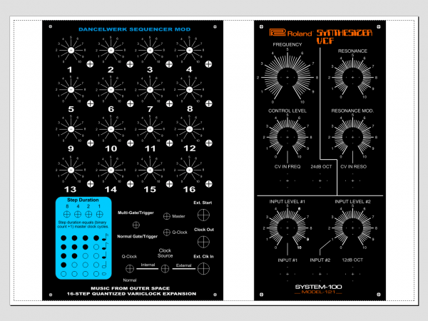

HI to all I made the integration of the sequencer variclock with my rotary design panel, courtesy of Thomas White and wonderfull design of Mr Ray Wilson, amazing sequence.
I have a few problems and I expose in the forum to Ray or somebody can help me.
Ok the main problem is that, I have no variclock quantize, I put the sequencer in Step Mode but when I move the pots of the variclock, it doesn’t work, the four leds of the quantize lits in the same place, there is not change. I try with the trimmer but I can´t see changes in the leds. I am using +/- 15V
For example if I turn off the sequencer and turn on, the leds lit in other combination, for example turn on: 1 1 0 0, turn off and on again and now I have 1010, again 1011, etc, always randomized.
I have not a 2 nf capacitor and I put X2 1nf in parallel for Capacitor C4, but I think this is ok. Am I wrong?
I cut the ABCD cables of the analog and digital pcb and I soldered all the cables in parallel abcd in the correct order with the variclock pcb, I trace with multimeter and ABCD of analog are connected with ABCD of variclock, the continuity it’s ok. I have +15 volts in all the pots connected to +15V rail, and ground its ok too, the x8 to x29 and x7 to x25 are connected ok with the new pots in the correct order.
I check all connections of the variclock pcb with the new and old components and wiring panel, it’s all ok

There is a jpg of the design for the panel to add, the other is a panel for the frequency control's vcf model 121 clone.

i forget it,
the multigate switch works fine, i think, when i put the switch in multigate i obtain two gates signals, to coincide with the leds of master clock and qclock.
the switch of qclock and normal, works fine, when i put in qclock the rate decrease suddenly and goes very slow rate.
internal clock or external works fine, i sync the sequencer with other sources.
all the sequencer works fine only the new addition of variclock doesn' t works.
i am waiting your answers.
DAncelwerk.
