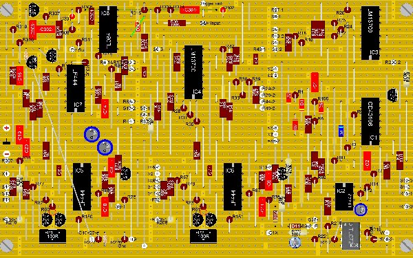

PostPosted: Mon Aug 16, 2010 3:04 pm    Post subject: Soundlab + Reply with quote  Mark this post and the followings unread
I used Uncle Krunkus' soundlab V2.0 Stripboard to make a Soundlab+ version. I have not yet built it from this drawing So I do not know if it works yet. I am posting it here in case anyone wants to correct anything wrong or to build one.
A few notes on what happened here.
1. I had to increase the size slightly. it is now 160 mm x 100 mm
2. The circuitry around IC8 is new and had to be squeezed into the lower right corner.
3. The new Noise circuitry would not completely fit around the existing one so it is place below IC5.
4. I changed the component values, deleted the unnecessary old ones, and created new ones where they fit. Many are in the newer Lochmaster format.
Please feel free to modify it further if necessary. I only ask that you post any updates for all of us to use.
This was my first use of Lochmaster so I can't guarantee accuracy. Also there was not a lot of room for the necessary changes.
Soundlab.zip

PostPosted: Mon Aug 16, 2010 5:10 pm    Post subject: Reply with quote  Mark this post and the followings unread
Good on ya jimh54! Very Happy
I haven't re-installed Lochmaster yet, so I can't look at it, but I will soon.
Is it done in the newer Lochmaster version?
If so, I don't think I'll be able to open it anyway.
On that point, it would be good if you can do a .jpg of both sides and post those so people can still use it even if they don't have Lochmaster. Let me know if you don't know how to do that and I'll give you a hand.
I've been thinking of doing exactly this for a long time, (but I don't have time!) I'd like to update my original SoundLab to the Ultimate and make it a matrix patch version, a bit like an AKS without the joystick.

PostPosted: Tue Aug 17, 2010 9:08 am    Post subject: RE: Soundlab+ Reply with quote  Mark this post and the followings unread
Uncle,
Yes, it's in Soundlab 3.0. Here are the .jpg versions.
I'm sure your version will be much better than mine. You have more experience and know where to move stuff around to give more room. I look forward to seeing it.

PostPosted: Mon Nov 12, 2012 5:30 pm    Post subject: Reply with quote  Mark this post and the followings unread
Hi guys! I'm building this SoundLab 1.1 (from Uncle stripboard in Lochmaster file) and i found myself totaly lost with wiring the panel --- i need your HELP! Shocked
I was wiring pots and switches looking at Uncle stripboard (for example R48-1, R48-2) and also looking at Ray's original wiring panel scheme, where on pots there are rectangles with letters (PP, RR and so on...) and i thought i'm doing fine but then i've found for example pot R19 --- on striboard there's ONLY ONE referance R19-2, BUT on Rays layout i see 3 possible connections (PP, RR, QQ) and i don't know what to to??? Also the numeration --- for example R44 --- i see A, B and C connections but is R44-1 leftside tip or the rightside tip (in other words does R44-1 goes to A or C?)
Guys, i would really appreciate your help, because i've spent so many hours sordering this Devil and now i dont wanna let it down... Twisted Evil
Thank you in advance
Posts: 2040
PostPosted: Mon Nov 12, 2012 11:19 pm    Post subject: Reply with quote  Mark this post and the followings unread
Each pot has three pins numbered 1, 2, and 3. So R19-2 means the middle pin (the easiest one to spot Smile ). So R19-2 can only be RR. PP and QQ are positive and negative supplies respectively.
For R44, if you compare the wiring diagram with the PCB layout, the PCB layout actually identifies any locations that are not common things like supply or ground. So for A B & C, you can look and see that A is R44-1, B is R44-2, and C is ground. That should also help because all the pots will be numbered the same way; looking from the rear, as the wiring diagram shows, you have pin 1 on the left and pin 3 on the right.
Hopefully this will help you sort it out Smile

PostPosted: Wed Nov 14, 2012 4:48 am    Post subject: Reply with quote  Mark this post and the followings unread
So i have finished SoundLab and it's not working, i only can hear faint hiss sound.....
Maybe someone can help me work out what is wrong?
First of all, where should i connect (+) and (-) wires from the stripboard, i have tried connecting them to R19, and also to Main Power switch and nothing happens, only this hissing sound. Maybe there are some other critical parts i should check out? I'm totaly lost and confused Sad
Posts: 2040
PostPosted: Wed Nov 14, 2012 5:05 am    Post subject: Reply with quote  Mark this post and the followings unread
When testing make sure the main, VCA and VCF frequency pots are turned all the way up. Then turn up the mix knob for each oscillator in turn.
I am out of town, and have not started on making this stripboard, so I can't give you a lot of guidance for that sort of thing; I would assume the + and - connections are the ones that go to the red and black wires to the panel, for the pots that get wired to +9V or -9V. But not having done it, and not having the time right now to go analyze it, I can't say for certain.

prgdeltablues
Joined: Sep 25, 2006
Posts: 222
Audio files: 12
PostPosted: Wed Nov 14, 2012 6:17 am    Post subject: Reply with quote  Mark this post and the followings unread
The point marked + on the stripboard layout needs to be connected to the positive output from your main switch (that is, the point labelled +9v on the power supply section of the schematic on the MFOS site, and PP on the panel wiring diagram). Likewise, the point marked - is connected to the -9V connection on the switch, QQ on the panel wiring. And the point in between on the stripboard, labelled with a sideways T symbol is the connection for Ground 'C' on the panel wiring diagram - it is unlikely to work without that being connected. It sounds as if you may not have connected the Ground to the stripboard.
hope this helps

PostPosted: Fri Mar 27, 2015 10:56 am    Post subject: Reply with quote  Mark this post and the followings unread
Ive made the soundlab+ stripboard version succesfully.
Sadly although the krunkus stuff is all correct, most of the mods to SL+ posted here had problems from missing the output of noise altogether, to no cuts under inverter opamp and a few more.
Id correct them all but dont have the file.
I do have one problem, but I have a hunch thats due to how Ive patched it and attenuated CV. The VCA doesnt go to silent, is that perhaps since Im using attenuators in front of the input resistors for VCA CV?
Worth mentioning its on +/- 12V as well (together with a 1 bus keyboard and a adsr circuit)
PostPosted: Fri Mar 27, 2015 2:50 pm    Post subject: Reply with quote  Mark this post and the followings unread
Remember that the more you load the power supply, the more the whole setup becomes susceptible to crosstalk. Make sure the supply can deliver at least 15-20% more current than you "need". Otherwise you'll get ripples in the supply (say from the VCOs) contaminating everything else, and vice versa.
Starspawn
Joined: Jun 14, 2013
Posts: 84
Location: Oslo
PostPosted: Fri Mar 27, 2015 3:19 pm    Post subject: Reply with quote  Mark this post and the followings unread
Yeah, I use a doepfer supply for their minicase in this so should be more than enough for only those three modules (ADSR is yusynth, so 10ma only).
It seems to me that when using 12V both the filter and the amp is dependent on the AD generator for their basic levels ... ie the filter reaches zero only on a highish AD setting, and VCA does not at all, so Im thinking the resistors at the CV inputs might need tweaking?
Or the added 27K in SL+ from V- to CV input for VCF and VCA?
(I have AD out wired directly to 4 pots each having ground on pin one, AD on three and out on 2)
I noticed that with the VCOs as well when I had to small resistor on one of the CV inputs there, but with stock both have a good range.
