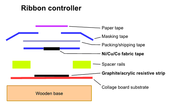

Finding materials for making ribbon controllers can be quite frustrating. None of the anti static bags or VHS tapes I could find had low enough resistivity to be useful. So I looked around for ways to make a resistive strip from scratch. It turns out to be quite easy. Most glues and paints can be loaded with powdered graphite to make them conductive.
The materials I ended up using are easy to find locally. They are acrylic ink (or paint) from the art supply / hobby store, fine powdered graphite from the hardware store and a Sketch & Wash water-soluble graphite pencil, also from the art supply store. The Sketch & Wash gives about a third the resistance of a regular soft graphite pencil.
I've done my first experiments using paper substrates. The acrylic ink also seems to adhere very well to acrylic (plexiglass) sheets, so that will be the next thing to try. The paper must be hard and flat -- any waviness will make it impossible to get uniform electrical contact. The best paper substrate I found is called "collage board". I got the Crescent brand medium weight sheets.
To get sheet resistivities down around 1 kOhm / square, as required for potentiometers under ~50 kOhm total resistance, more than one conducting layer is needed. I usually start by using the Sketch & Wash pencil to load up the paper and then add a layer or two of graphite-loaded acrylic ink. This needs to be mixed up with about 3 parts graphite to two parts of ink. It is critical to get fine graphite powder. I was able to find this at Ace Hardware. The other stores sell a kind with large flakes, which doesn't work at all. You can also find large quantity bottles online.
The paint usually needs some careful fine sanding to get uniform resistivity along the strip. To measure the local resistivity, you can do this: Take a small strip of wood, about 10 mm x 15 mm. Wrap small strips of Al foil tape around the ends to define a small square with the contacts along two sides. Then just use your DVM test probes to push the little device against the resistive strip. This doesn't exactly give you Ohms / square, but it's OK for relative measurements to check the uniformity of the potentiometer strip. With some practice and patience it's easy to get linearity better than 5%.
I usually go over the strip again with the pencil pressing hard to get a well burnished shiny surface.
For the conductive strip that presses against the resistive strip, I found a rather remarkable product. It is called "Ni/Cu/Co Conductive Fabric Shielding Tape" and is available at lessemf.com It's very flexible, has a nice fine uniform weave and has metalic conductivity. I just hang it over the carbon strip between a pair of simple clamps.
The attached drawing shows how I used layers of paper and tape to build up a controller. This is a cross section of the central part and doesn't include the details of clamping and contacting. These are done with brass bars that screw down on top of the conducting strip, and Al foil pasted to the end of the resistive strip with conducting glue made from graphite-loaded acrylic paint. The paper tape on top has a feel that I like better that the acrylic of the packaging tape that carries the conductive tape. I comes from the drug store and is called Nexcare Gentle Paper Tape (aka 3M Micropore surgical tape).
I hope all this at least gives a basis for folks who want to try experimenting with DIY ribbons.

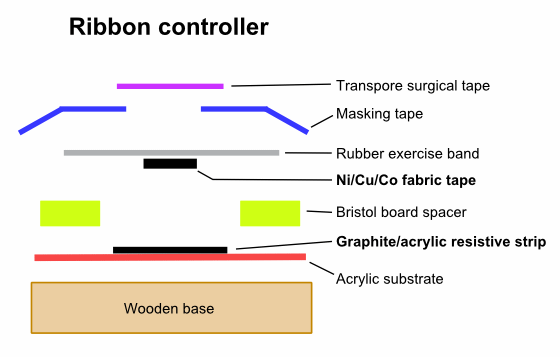

Here's another ribbon version. This one is built on a two foot long base, with an active length of ~530mm. In this version, the resistive strip is painted directly on a plexiglas substrate. It has been carefully adjusted to have better than 1% linearity. The conductive-tape ribbon is suspended over the strip by a piece of rubber cut from an exercise band. This forms a nice and wide and very comfortable, organic-feeling trough for the finger to ride in. The top layer is Nexcare "flexible clear" tape from the drug store. It has a nice tooth so you can feel your finger move without having a lot of friction or bending resistance. This device is an absolute joy to play. It kicks the crap out of the softpot with its narrow, unconfined, hard and sticky surface.

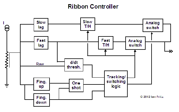

Finally got a nice long linear ribbon working. Also improvements to the circuit that make it pretty much bulletproof.
The ribbon is similar to the ones described above. I painted a strip of acrylic gesso right on a piece of wood, then loaded it up using the water-soluble graphite pencil. The strip is ~ 1" wide and 2' long, and its resistance is ~5kOhm. So multiple layers were not needed. This is because the gesso has a lot of "tooth" (that's what it's for). To linearize the resistance I painted acrylic ink loaded with powdered graphite along the edges where needed. I got the final linearity down to around +/- .3% FS. This is 10x better than the Softpot spec!
I got the circuitry tweaked up to where there are very rarely errors with normal playing. It will still gurgle if the ribbon is pressed very lightly, and you can get an error occassionally if your finger is right on the edge of the track.
A block diagram of the electronics is attached. The raw signal is processed in several parallel branches. Complementary comparators detect the finger up and down events and fire a one-shot for blanking the Track/Hold circuitry for a fixed debouncing time.
The raw signal is fed through two lag processors, one "Fast" and one "Slow", each with its own T/H circuit. Lagging produces signals that are smoothed and delayed. The difference between the Raw and Fast lag signals is a measure of the rate of change of the signal and is used to inhibit tracking when it is above a small threshold.
The Fast T/H is the main output when the finger is down. It is sent to the output via an analog switch, provided there is no blanking signal. Upon finger release, both T/H circuits are set to hold, and the output is taken from the Slow lag circuit. The eliminates droop during the switching time.
I'm still thinking about ways to improve the electronics, so there may be further changes. But right now I'm very happy with how it is working.

LFLab wrote:
Any worries about the longevity of the masking tape? I can imagine that the adhesive used is aimed at removeability after painting?
True. It's pretty sticky, though. I'm not using it for the active layers anymore -- it wasn't springy enough for that.
I wonder about the blackboard paint that you can also get in spraycans (at least this side of the pond), I know some people use it for shielding guitars, so perhaps it has too low resistivity. Not sure if that lacquer is loaded with graphite or something else.
I went out and got a can of blackboard paint to try, but it doesn't seem to conduct at all. Is there a specific brand I need to look for?
Ian

Of course, this assumes you lift your finger cleanly and rapidly. Sometimes I have had trouble with the pitch shifting no matter how clean the lift is. This looks to usually be a mechanical problem, for example a flaw in the strip or ribbon. A flaw can actually cause the pitch to shift before the circuitry detects that the finger contact is broken. On my most recent build, notes at the low end of the resistance range (highest pitches) had a tiny bit of shift. I was able to get rid of this by shimming the end of the ribbon up a bit, and by increasing the minimum finger-up signal by shifting a reference level in the circuit. This also got rid of a small voltage shift when pressing below the selected pitch.
The fast lag circuit -- which provides the output while the finger is down -- is 10x faster than the slow lag circuit. This allows clean trills. Well, they glide a tiny bit for really large intervals, but this isn't much of a problem.
I hope to put together a pdf on this project, rather than post all the details on the forum. Too hard to get the attachments in order, for one thing. Very Happy
Ian
