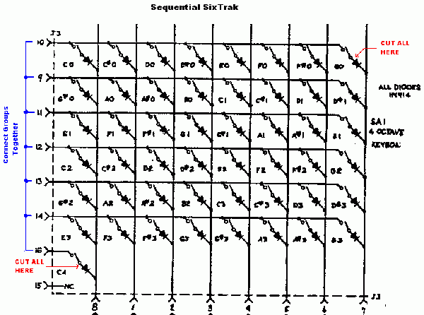

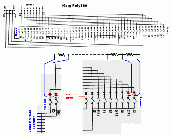

Written against my better judgment...
All matrix KBs will have a diode for each switch. Clip out the diodes or *cut the ends that connect to each switch, bend the diodes up, and solder the resistors of your "string" to the stubs. Wire all the groups of switches together and that becomes the single buss.
There are at least two variations of where the diodes are located in relation to the switches;Attached I show both. The method of alteration will be the same. The "groups" might be of eight keys, 12(+1) for octaves, or six(+1) for half-octaves. Yamaha and Casio are (in)famous for devising odd-ball groupings. Fatar's 2-switch per key (make and break,) KBs will be a little more trouble. Clipping/cutting should be done at the "make" switches.
Good luck dealing with any switch resistance.
By no means is all this intended to be an endorsement of finicky, resistor string voltage divider and droopy sample & hold single-buss designs.
*This way, the diodes can someday, when you've realized the error of your ways, be soldered back for a scanning design - which, btw, doesn't have to be interfaced with a microcontroller.
http://www.musicfromouterspace.com/analogsynth_new/OLDIESBUTGOODIES/CONTROLLERS/scanningmatrixkeyboard2.html
I don't understand why Ray has made this design harder to find.
Diodes will be reversed in KBs in which a pressed key causes a logic 0.
