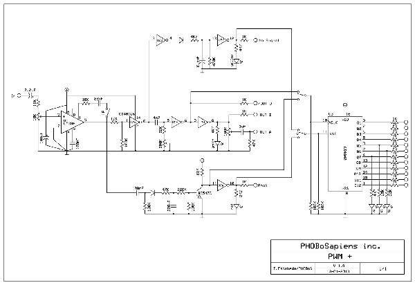

I was browing Draal's blog while I was waiting for some paint to dry and stumbled upon
Tim Escobedo's PWM circuit.
I was thinking of making some circuits to convert music to other usefull control signals and this looked simple enough
to give it a try. So I breadboarded the circuit and started modifying it.
The first thing I did was remove the bridge between pin1 and 8 which sets the gain to 200x. If you want to use a guitar
(what the circuit was originally intended for) or a microphone this amount of gain is useful but I will be using it for
line level signals. I also added an attenuator for some better input level control. The capacitor/resistor feedback loop
between output and pin 1 is something I found in an old electronic magazine (ELEX) and was labeled bass boost, but it
sounds like it actually filters out the high frequencies.
The original circuit only uses 2 of the 6 inverters so I started to think about what I could use the other ones for.
To get a bit of an indication about the input level I added a peak indicator: First the offset voltage of the LM386
get's removed by a capacitor/resistor, then the positive part of the signal is used to charge a capacitor. If this
voltage get's high enough the transistor pulls the input of U2e below the treshold level and it's output goes high.
I selected the values by checking the output of the LM386 with my scope so that the LED turns on just when it starts
to distort. [You could use this circuit as an addition whenever you use an LM386 amp and if you don't want to use an
extra schmitt trigger inverter you could just use the transistor to drive a LED directly. However it will not turn nicely
on and off and you will probably have to change some component values a bit to get a nice indication.]
I still had 3 inverters left but before I used those I added the 4040 divider. This is something Draal also mentioned
and it works great to turn the input signal into related CLK signals. Just for fun I added the RGB LED, but you can leave
it out of course, allthough it does look very nice colors
This LED is also where the idea for the 'no signal' output came from. Basically I just wanted to turn it off when there
was no music and for this I needed to make the reset input of the 4040 high.
I made a similar circuit as for the peak indicator but without the transistor so it's output goes low when the
capacitor is charged. However sometimes it worked fine and the indicator LED would turn on when there was no signal,
but other times it would stay off. I took a look at the ouput of U2a and it behaved the same. so I checked the output
of the LM386 and, as I could have allready guessed, it's at 1/2 the supply voltage when there is no input signal. And
because this is between the treshold levels of the 40106 it behaves unpredictable (I think). To solve this I added a
voltage divider so instead of 1/2 the supply voltage the input of U2a is now below it's treshold level and it's output
will be high, this get's inverted by U2b for the 'No Signal' circuit. With the current component values it tuns on after
about 1 second of silence or when the input level is too low. I am thinking of adding a bigger capacitor and replace the
470K resistor with a pot to make this time adjustable.
And finally U2d was added so the output is low without an input signal. Since the 4040 is triggered by a high to low
transistion I used the output from U2c (inverted) but with these signals it doesn't really matter. There's also a line
output with level control to use it as an audio effect processor. (it's original purpose) Cool

Good idea to think about that gain reduction on the 386. I've run keyboards through it and the signal is hot for sure. Useable, but distorted (this may be acceptable for some of us alchemists Laughing ). Perhaps I'll consider a switch or adjustable gain setup when I get some free time.
It's very cool to be able to add distorted vocals in the mix when plugging away/recording or use your voice to trigger other sequences. All of a sudden, you are adding an organic , unpredictable element to setting up a sequence or adding true randomness.
More fun: Connect the output of the PWM to the 4046 Pitch Tracker for a simple device that will transform anything you input: voice, instrument, contact mic, into warped out sounds. I've tried tapping on various things close to the mic as well as contact mics for lo fi drum sounds too.
It's a fun module or building block in any lunetta for sure. I wanted something to square up my guitar and mic signals so I could incorporate them as triggers or sonic shapers in my machine.
With your mods, it'll be interesting to see what line level elements can be put into the mix. Time to experiment....
The amount of gain you need also depends on what you use it for, if you want some CLK signals,. it works nice if
you set the level so it just clips, however the input signal is much more recognizable if you turn the gain up a lot.
So I'm gonna add a switch aswell,. but as far as I know you should add a capacitor between those pins, not just short them
allthough that seems to work too. wait let me check the datasheet Wink
To make the LM386 a more versatile amplifier, two pins [1 and 8] are provided for gain control.
With pins 1 and 8 open the 1.35 kΩ resistor sets the gain at 20 (26 dB). If a capacitor is put from pin 1 to 8,
bypassing the 1.35 kΩ resistor, the gain will go up to 200 (46 dB). If a resistor is placed in series with the
capacitor, the gain can be set to any value from 20 to 200.
So I guess I'll put a cap in there.
btw it continues with
Gain control can also be done by capacitively coupling a resistor (or FET) from pin 1 to ground.
that might be usefull Very Happy (maybe I can add automatic gain control thinking)

PostPosted: Sat Mar 28, 2015 4:34 am    Post subject: q Reply with quote  Mark this post and the followings unread
im not sure I get what is going on here (see photo-section marked in green and red)-it looks sorta like a resistor ladder but where id expect to see the output on one side and ground on the other it isnt set up that way.
Are you using it as an arpeggiator to send increasing voltages repeatedly? or to do DAC?(seems unlikely)
Also, the circles (if it was standard ladder) would be digital inputs (as per # of bits and n-bits )..but im thinking thats not the case here-so what are the circles ive marked in green?
Im sorry if these are stupid questions, im just curious and i honestly dont know the answers.

PostPosted: Sat Mar 28, 2015 6:12 am    Post subject: Re: q Reply with quote  Mark this post and the followings unread
The 1K resistors are just current limiting resistors to protect the outputs of the 4040 divider chip in case of a short.
I guess you could connect all the outputs together to create a voltage but that's not what they are intended for.
The circles are the connection-/patch points which in my case are M3 bolts.
I also have LEDs on all the outputs as can be seen in the updated schematic.
