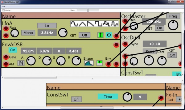

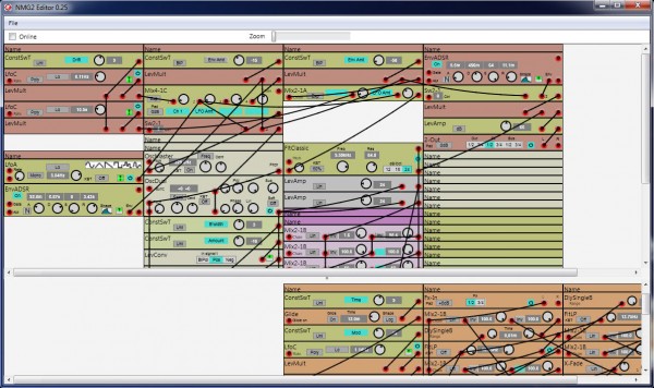

brunov
Joined: Aug 03, 2011
Posts: 219
Location: delft
PostPosted: Mon Jan 28, 2013 1:13 pm    Post subject: Reply with quote  Mark this post and the followings unread
Such a pity that you are a programming illiterate Smile But maybe you're an computer graphics artist? I have discovered that I'm really bad at computer graphics.
I think I can maybe do the application code part of an osx application, because Delphi lets me compile for Osx, but when it comes to specific osx knowledge or computer graphics I'll have to throw in the towel.
What I would like to do is make some sort of application framework that is decoupled from the graphics. So someone who is more capable can design a skin for the application. I could reuse a lot of the code that handles the loading/saving of g2-files and sending messages over the usb interface from the windows application.
The main thing that would have to be made from scratch is the gui. I would like something that you can zoom in and pan. That's not so hard to make in the new delphi compiler since they are all focussing nowadays on the growing tablet market. The only thing is that you have to use graphics that allow scaling.
So in the screenshot I made a test application and with the 'Zoom' slider you can enlarge the gui. You can see in the zoomed-in picture that the bitmap/raster graphics become very ugly when enlarged, for example the waveform icons on the LfoA.
What I would like to do is enable the application to load SVG graphics (http://nl.wikipedia.org/wiki/Scalable_Vector_Graphics) in stead of the bitmaps and maybe also for some of the controls and panels. So anyone could design parts of the gui using for example http://inkscape.org/ and then give it the appropriate filename so the application can use it in the gui.
There will be quite a lot graphics that have to be designed.
But that's basically the status right now: a couple of ideas and modest progress on the application.
The main thing is that I don't want to work on it alone anymore, I think the project needs some other people involved not to grind to a halt.

What I could do is export all the images from the current editor to file using a specific naming convention. These can then be recreated as SVG graphic, using for example Inscape. Because of the naming convetion, the application knows where to use them in the gui.
About the controls:
That's a bit more complex beause the application must be able to change certain parts of the graphic to animate them.
In SGV different parts of a graphic can be given an ID.
For example a led has two states so in the SVG graphic maybe two layers can be created representing the two states of the led. Then the application can turn the led on by making layer with ID2 invisible or off by making layer with ID1 invisible.
Maybe for each control a skeleton SGV graphic can be created already containing the layers/parts with the appropriate ID's to link them in the application. Then the graphics designer can adapt the skeleton SGV to make it more visiually appealing.
What I would like to do first is to develop the SGV object for Delphi and to make some sample/test applications for Windows and OSX to test some things out.
I'll post them here if I have something ready, but it'll take some time...

i just try your editor and read about the hidden modules..really nice..
where are the limitations of the opn source editor right now?
is it possible to enable some other of the hidden modules? like the blue to redconverter or the dx env?
brunov
Posts: 219
Location: delft
PostPosted: Wed Feb 06, 2013 11:10 pm    Post subject: Reply with quote  Mark this post and the followings unread
Thanks for your offer to help out Sven. Smile
I guess you already found the help file I wrote:
http://www.bverhue.nl/G2EditorHelp/NMG2_Open_source_editor_help.html
The main limitations of the editor are in my opinion:
- No OSX version yet
- No patch load calculation :memory/cycles
And then there are some minor things missing:
- Switching a module to another using the icon on the left top
- Copying morphs/copying parameters
- Som bugs in the midi control pacakage I used
About the missing modules. I found these trying out some "add module" message with different parameters.
In the list shown here, apart from the Driver/Resonator only the Blue2Red and Red2Blue also seem to work. Any idea what these could be used for?
// ModuleType ShortName
// - AR-Env
// AudioIn
// Blue2Red -> Testmodule
// BusIn
// 77 ClkDivFix -> Doesn't seem to work
// 35 Driver -> Works!
// EnvDX
// LfoD
// Mixer6-1A
// Mixer6-1B
// OutBusA
// OutBusB
// PeakFollow
// 101 PolarFade -> Doesn't seem to work
// 120 PolarPan -> Doesn't seem to work
// 10 PulseOsc -> Doesn't seem to work
// Red2Blue -> Testmodule
// 56 Resonator -> Works!
// 207 RndChaos -> Doesn't seem to work, but shows up with id 6,95,136,138
// RndDistr
// RndState
// RndStep
// SeqA
// 104 ShelvEQ -> Doesn't seem to work
// 14 SyncOsc -> Doesn't seem to work
Page 14 of 20 [498 Posts]
