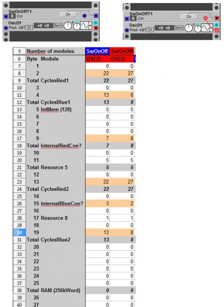

About the patch load calculation, I think I made some progress, by studying the manual again and some experimenting:
Resource 3 (byte 5) represents Internal memory, max 128 bytes.
Resource 10 (byte 20..25) represents RAM, max +- 260000 bytes (256kWord)
This fits for most modules, but there is still a factor missing
So memory calculation should be:
Mem% = max ( (100*R3/128) , (100*R10/260000), (100*R?/?))
And the Cycles, I made a discovery by uprating a module, so a module that has normaly blue output, turns to red output when modulated with a red source, as shown in the picture.
So I think Resource 1 (byte 1,2) and resource 6 (byte 12,13) represent Red Cycles and Resource 2 (byte 3,4) and resource 9 (byte 18,19) represent Blue Cycles.
Don't know why they are put in twice, and don't know exactly what the max values should be. Resource 5 also plays a part in the cyles. So for know I have this formula which comes close:
Cycles% = max( (100*R1/1352 + 100*R2/5000), (100*R5/258) )
So far the patchload.

PostPosted: Mon Feb 11, 2013 11:45 am    Post subject: Reply with quote  Mark this post and the followings unread
nice progress..seems to work.. what missing factor in the memory calculation? sofar the formular worked on all the patches i looked into.. can you point me to one where this dont works?

PostPosted: Mon Feb 11, 2013 12:15 pm    Post subject: Reply with quote  Mark this post and the followings unread
It's the 2Out module, which has no internal memory usage and no RAM usage but the clavia editor shows 0.4% Mem.
What I find really strange is the difference with the 4Out module, which uses no memory at all, according to the clavia editor, and only 0.1 cycles. The 2Out uses 1.7 cycles, so 17x as much cycles.

PostPosted: Tue Feb 12, 2013 11:01 am    Post subject: Reply with quote  Mark this post and the followings unread
i ve some patches where byte 1,2 are not identical with 12,13
and also patches where 3,4 is not identical with 18,19
byte 13 seems to relate to the missing resource..
while byte 1 is identical with byte 12 in most cases , but not all.. byte 2 is not identical with byte 13 when only output modules are used.
byte 9 an 11 seem to be involved in the cycle counting too, at least byte 8 and 10 get higher than zero when cycles go above 100%
I've seen that also, for example with the lfo. There are probably two factors involved that determine the amount of cycles of a patch, each with a certain maximum. Maybe we'll have to find two modules, one that uses more of the resource of byte 1/2 and the other that uses more of 12/13. Than put as much of each module in a patch until you reach the 100% to determine the maximum of the resource.
