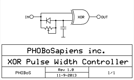

PostPosted: Wed Sep 11, 2013 7:49 am    Post subject: PWM with a single XOR gate
Subject description: can easily be added to a CD4046 VCO
here's a method which I thought up while trying to sleep. (I count electrons not sheep).
I have a CD4046 VCO wired up with it's output (pin4) connected to the Internal Phase Comparator I (pin3), which is just an XOR. And at some
point I wondered what happens if you connect the output of the VCO to the signal input (pin14) which is the other input of the XOR. Well that
would mean that the inputs of the XOR are just shorted together and therefor it's output will always stay low. So not very intersting,..
But that got me thinking,. what if I delay one input ? Then the inputs would be different from each other for a short time and therefor it's output
will also be high for a moment. In other words I can control the pulse width. Very Happy A simple adjustable delay can be made with a potentiometer and
a capacitor, and by adding a diode parallel to the potentiometer, the capacitor will get discharged instantly when the input goes low and so will
the output.
I did expect one problem, that is without a schmitt trigger input such a simple delay might not work so well, and cause unwanted oscillations.
So I just breadboarded it but I had to use an external XOR (CD4070) because I have the VCO build on a PCB and only made the XOR output
available. Well, it works perfect. Laughing And the diode seems to take care of the unwanted behaviour I expected, without it I do see and hear some
extra oscillations.
The maximum 'on-time' is the same as the input signal and since the CD4046 has a pulse width of 50% I can't set it longer than
that. So with the right capacitor (dependent on the frequency) it's adjustable from 0 to 50%. But soundwise making it longer would sound
the same anyway. a 500K pot and 10nF capacitors seem to work nice.
fun fact: when I tried to adjust the circuit to work with NAND gates, I ended up with the same circuit I posted before. Cool
 Filesize:  15.08 KB
 Viewed:  29002 Time(s)

PostPosted: Wed Sep 11, 2013 12:20 pm    Post subject: Reply with quote  Mark this post and the followings unread
A very ingenious and elegant solution. Nice work Phobos! thumright

PostPosted: Thu Sep 12, 2013 9:31 am    Post subject: Reply with quote  Mark this post and the followings unread
pulse width % will vary with frequency. these circuits provides constant pulse duration, so the timbre of the notes will change. with a cap in line with a pot to ground bass notes will sound very thin and reedy, while the higher you go the closer the pulse width percentage will be to 50%. close enough for jazz, though, amirite?

Posts: 4584
Audio files: 635
PostPosted: Thu Sep 12, 2013 10:58 am    Post subject: Reply with quote  Mark this post and the followings unread
yes I think you're correct. The pulse duration is set at a fixed time so if the frequency changes the pulse width will change too. And the pulse
duration will be a smaller % of one period at lower frequencies then at high frequencies. Of course without resquaring the signal it would just be a
passive highpass filter which would have a similar effect on the sound but it's not the same I think. (something with harmonics). So the thin and reedy
sound is in this case a result of changing the pulsewidth.
The circuits I came up work slightly different and work well with low frequencies. At least the first one was designed as an LFO the other one is
just an easy way to add pulse width control to a 4046 but can be used standalone and also works well with an LFO. But the pulse width does also
very with frequency. I don't think there is anyway around it unless you go for a different approach like a sawtooth oscillator + comparator.
edit: I think I need to type faster, this was a reply to psyingo's first post

I would add a diode to create a saw instead of a triangle, else you don't just get pulse width control but phaseshifting aswell (unless that's a wanted feature).
well actually I'd just grab a quad opamp if I go that way, and leave out the 40106 completely.
very very true. many ways to do it, and i hadn't considered the phasing issue. The OP referred to a 40106 oscillator, but you could do it any way. many ways to do the same thing.

Another way to do it is to use a second osc to modulate the pulse width.
If you use a D flipflop and send one osc into the clock and the other into data and also XOR(XNOR?) it with the Q out, you will have a square wave with the period of one and the mark of the other.
Maybe not the best way if you need frequency and pw to always be synced or if you don't want to use a bunch of chips, but this way gives you a lot of control and makes some really crazy sounds if you hit it just right.

Dear Phobos,
Thank you for the elegant little PWM solution. It helped me so much to control the shuffle of my Solenoid Tambourine (see video below).
Now if you have a simple Voltage Controlled PWM trick up your sleeve for my Servo drum module...
Izhar
[img][/img][url][/url]

I don't know much about servos and don't have a whole lot of experience with them but maybe you can
get some inspiration from the voltage controlled servo I used for the spring reverb in my Frankensynth.

I added some rudimentary cv input to the xor pw controller. Works in simulation. I hope I find some time to breadboard this soon. The duty cycle range (which can be controlled by the control voltage) depends on the input frequency and the capacitance at the second input of the xor gate. With the additional capacitors and switches it should be possible to voltage control the duty cycle (~10-50%, maybe 50-90% with a nand gate instead a xor gate) over a relatively wide range of input frequencies. Not very elegant, but it should work just fine.
