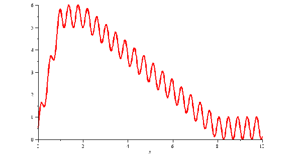

I'm in the process of building analog-synth-like features into a PAiA Stringz'n'Thingz string synthesizer (keeping all the capabilities of that as well). I plan to post the details on my web site when I'm done (and I'll post some pics and info here too), but I have a question for you all:
I plan to provide both ADSR and LFO modulation of the amplitude, and I'm wondering if people generally use two separate VCAs for that? I realize it's possible to sum the ADSR and LFO voltages, but then one of three things will happen:
1. If the LFO output has its lower peaks at 0V and its upper peaks at say 1V, then the sound through the VCA will continue being turned on and off even after the ADSR has gone back down to 0.
2. If the LFO output has its upper peaks at 0V and its lower peaks at say -1V, then once the ADSR output drops below 1V, the LFO will turn the sound fully off during parts of the cycle. So as the note fades away, a subtle tremolo will turn into a choppy "beeping".
3. If the LFO output is centered around 0V, then both of the above undesirable effects will happen.
It seems to me that one should use the LFO, together with a fixed bias voltage, to modulate one VCA, and then take the output of that VCA and feed it into another VCA controlled by the ADSR. In addition to avoiding the aforementioned undesired behaviors, this results in the LFO modulation remaining as a fixed percentage of the current volume, so that the tremolo won't become more pronounced as the overall volume decreases.
Am I missing something here?
Thanks, Stefan
Description: |
LFO with 0 to 1V range, ADSR with 0 to 5V range, voltages summed. Notice beeps after ADSR has gone to zero. |

On the Nord Modular (a virtual analog) I'd use two VCAs for this. _________________ Jan

You might be able to accomplish this effect if you add a little negative bias to the combined ADSR and lfo voltages.
If your LFO is, say, 2 volts peak-to-peak, then with a -2 volt bias, no bleedthrough will occur when the ADSR is at zero.
What WILL happen is that the attack will vary depending on where the LFO is in its cycle.

Thanks Kevin. I think that's more or less what I did in the 2nd graph in my original post. The LFO is 1Vp-p, and there's a negative bias so that it remains below zero all the time, thus giving no bleedthrough after the ADSR is done. But, there are still the pulses during the last part of the release cycle, when the ADSR is almost-but-not-quite done. Perhaps in actual use, this doesn't matter, because the release times are relatively short and the LFO cycle times relatively long.

stefanv wrote: | ...there are still the pulses during the last part of the release cycle, when the ADSR is almost-but-not-quite done. Perhaps in actual use, this doesn't matter, because the release times are relatively short and the LFO cycle times relatively long. |
That's true. In my track, the lead part had a good deal of reverb and that masked the note tails.

Here's another idea. My Emu VCAs have a mode where one control input acts as a multiplier for the other. This allows you to have tremolo that decays properly to zero. This is all done in the control circuit without adding another VCA. |

riley smith wrote: | Here's another idea. My Emu VCAs have a mode where one control input acts as a multiplier for the other. This allows you to have tremolo that decays properly to zero. This is all done in the control circuit without adding another VCA. |
So it's multiplying the control voltages instead of adding them? I think that basically means there are still two VCAs, but one of them is being used to modulate the control voltage of the other (instead of modulating the audio).
I ended up going with two VCAs in my design, since they're pretty cheap and easy to build. Now I just have to find the time to start actual physical work on this project (all the schematics and board layouts are done, and I have all the parts except some of the pots). _________________ Stefan Vorkoetter

Just a little brain storm here...If you use a Voltage Controlled ADSR, you could run the LFO into the Sustain CV of the Envelope instead of into the VCA itself. Then, the LFO will only modulate the VCA when the Envelope is in its Sustain cycle. Not as flexible as both an LFO and Envelope input to the VCA, but it might be all you need.

I can't get a clue how to mix output of the VCAs to achieve the "correct" effect without bleeps... If I'll mix two via a simple mixer the bleeps won't go away. It would be great if you guys can clarify this moment.

I would use one VCA to modulate the output of the other one .. so .. not add them in a mixer but multiply rather. _________________ Jan

some more thoughts about it ... you seemed to want to add two VCA signals, where I think they should be multiplied ... a VCA essentially being a multiplier ... so .. two cascaded VCAs where one applies an envelope and the other applies the LFO. The LFO would need an offset added to it to make it a positive only signal. _________________ Jan

VCA ==multiplier ... so you just put one after the other, no need for anything additional (except the LFO and the envelope) .. hmm not even that is needed as the Envelope modules have a VCA built in already.

Thank you for your reply, kinda helpful! Now I really understand that VCA is working like a multiplier. Was unaware of that.
The leftmost example is really simple, the AM input allows to modulate the whole level of the envelope using any external source. Now i understand how to make a sequenced pattern with note gaps since the note sequencer doesn't provide a way to skip a note to get a silence instead like in all DAWs the piano roll allows. In g2 I can just send a zero value using a value sequencer in the AM input of the envelope and viola ! and it allows to control the sequencer velocity as well.
But what is the downside of this method with modulating the AM input? I didn't hear the difference between all the methods though I understand that the middle example is the same as the leftmost but with external VCA applied. And the 3rd one is really a closest to the original description.
Btw, you said that the lfo is biased but I didn't notice that...its just a regular unipolar lfo at a 2.72 hz frequency. would be great if you can explain it. |

i got it, the lfo is a positive only! thx! |

All three are the same ... _________________ Jan
