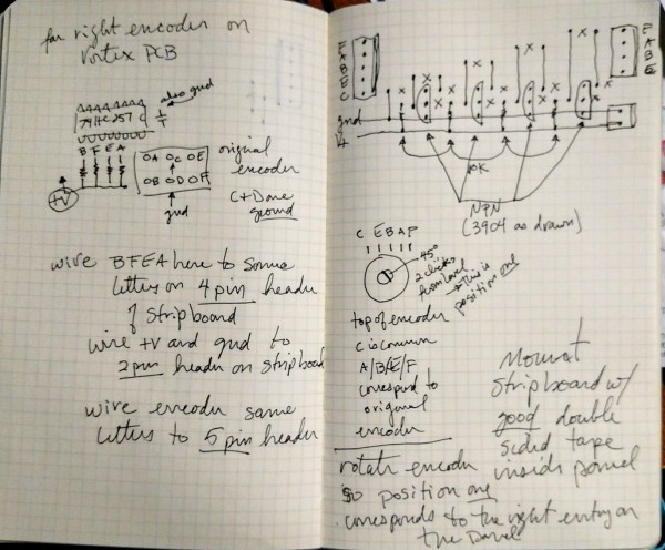

I got a free Lexicon Vortex because two of the three encoders were on the fritz. After ignoring the warning that the encoders were unobtanium, and finding that to actually be the case, I came up with my own solution to the problem:
https://plus.google.com/102657837209811792502/posts/JBjb1sB3KHR
I haven't done a complete put-it-all-back-together test, but I expect to in the next few days. I wanted to stick my toe into the water and see if there would be any interest in the community at large for a solution to this problem without being able to buy the actual encoders.
the TLDR version is that I have a standard hex encoded switch/encoder, driving a PIC, driving transistors to emulate the original switch.
If there's enough interest, I'm interested in possibly making PCBs.... If not enough interest to be worth all that, but someone still needs help I'll be happy to share my stripboard layout and code. Testing the waters first though...
And no, I'm not going to post to Muff's until I've actually put it all back together and confirmed it, so this is sort of "pre-release" cos I know this community is not nearly so overwhelming Very Happy.

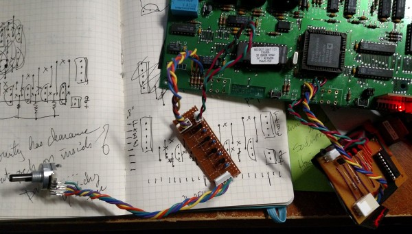

PostPosted: Fri Dec 09, 2016 8:25 pm    Post subject: Reply with quote  Mark this post and the followings unread
Well this still makes (sloooowwwww) progress.
I got a line on a grey coded encoder that I was told was a drop in for some other Lexicon gear, I thought maybe I'd get lucky, and it would also work for the vortex. It's a MUCH sturdier encoder than the grayhill ones I have referenced previously.
Unfortunately it is 1) inverted (closed when the other is open, and vice versa) from the original, and 2) offset (position "1" when mounted to the panel has the encoder at a 45 degree angle from square) from the original.
HOWEVER
Having it made me revisit the idea of how this could work, and even with the inversion and offset, this is a better solution than I had before. Primarily because, while I still need a PCB to do the inversion, and it can't be mounted directly to the encoder because of the offset, I no longer need a PIC. I've built it on a .8" x 2.25" piece of scrap stripboard. I can mount this on the inside of the face for both the presets and the values, and if I made a real professional PCB, I'm confident I could make it much smaller and get it to fit next to the other encoder as well.
See the attachment for a photo; on the right, the encoder with the PIC, on the left, the new encoder and the much smaller stripboard.
Works flawlessly.
The encoder itself, like the grayhills, requires making the mounting holes slightly larger, and unfortunately my source on ebay didn't include nuts, so I have to dig around through my various castoffs to find a nut that will work. But a nice piece of quality double sided tape and the nut, and I've got this well licked.
ALSO unlike the grayhills, the original knobs fit these encoders!
So overall, despite not being what I had hoped, a net win.

PostPosted: Sat Dec 10, 2016 12:12 pm    Post subject: Reply with quote  Mark this post and the followings unread
Some of the details. Needs a diagram of the far left encoder, it's layout is different from the others in terms of the 4 resistors you see on these.

SLOOOOOOOOW man has moved forward with this project again Smile
I have fixed one other person's Vortex with the boards pictured above.
But after some consideration, I think I can make SMT fit better (cuts the size of the PCB by about half).
I have more encoders and another person's Vortex on its way to me now and I'll be trying it out with mine first then hopefully fixing his....
