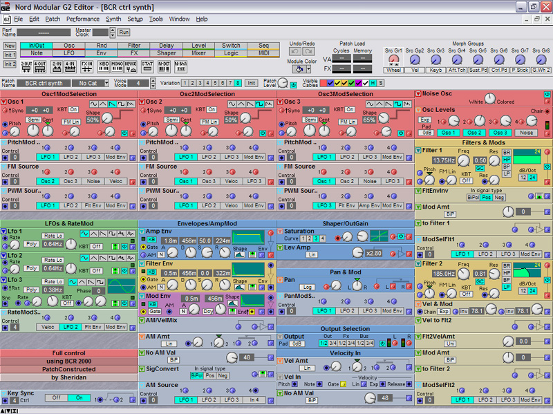

Hi there,
I've recently been working on a lovely G2 patch (3 Osc, 3 Env, 3 LFOs, 2 Filters, Satuartion, plus multiple modulation possibilities) with pretty much every control assigned to a knob or button on my BCR2000. There are only a couple of modules and parameters not under control! I thought that I would share this with everyone here.
NOTE: I originally had a problem attaching the sysex file to the post, but I have now attached it below.
Anyway, I started this synth as a basic 2 osc, 2 filter synth - kind of a patch to start building from to save time. So I assigned all the synth's controls to knobs and buttons on the BCR, but there were some left over... so I added more to the patch... and more! I started with a button for each variation, but in the end, demoted it to a single button to free up other controls for more sonic control.

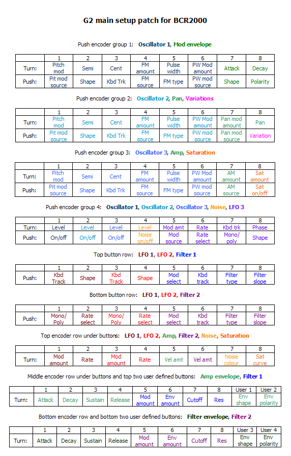

I have tried as much as possible to 'mirror' the on screen controls to the BCR2000 controls. I have been using it for a while now and am quite happy with the button/knob configuartion (I have changed most of them several times!!!) As there are so many controls, I have typed them out to help make sense of them all. I have attached that too.
There are lots of places where 'cycles' can be saved by deleting whatever you don't feel you need. I have gone through and created quick patches on each variation, but more to show the synth's capabilities than to be 'outstanding' sounds... although I think they are pretty good.
If anyone can suggest any improvements or better ways of some of the connections to the G2 patch, I'd be happy to hear them, as I'm still a 'modular-newbie' and this is my first real patch that I have shared.
I hope you all enjoy it!!
Kind regards,
Sheridan
P.S. please let me know if there are any problems.
NOTE: See next reply for G2 screenshot.
Thanks to Cappy, I can now bring you a screenshot of the full list of BCR2000 control assignments for the attached G2 patch.

edited: I have attached the Word Doc of the list of control assignments just in case anyone wants to change some controls and update the list accordingly and a screenshot of the G2 patch for your convenience.
Screenshot of attached G2 patch.

I was hoping to get a bit of feedback guys... I am a newbie remember? There must be some 'patching' improvements that can be made, surely? It's pretty much my first 'big' patch... there have to be some mistakes, don't there? Anyone? I am trying to learn more about this.
Thanks.
