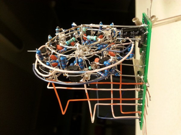

I'm here to say "HI!!!" and to introduce myself and my build technique. I'm kind of a point-to-point and deadbug ninja.
See, I can't afford PCBs, I'm too impatient and disorganized to make my own, and even perfboard and stripboard can be limiting.
Some of my circuits (like the Linkwitz-Riley crossover pictured) are intentionally beautiful. That circuit was easy to make pretty because it's many iterations of basically the same circuit.

My technique is basically breadboarding (original sense, not with the solderless breadboards -- I've never had luck with those) but on thick card.
I glue paper shopping bag three layers thick, cut it to size to fit in my enclosure, which is almost always a tin can. I usually put a bare copper wire (stripped Ethernet cable wires) along the top and bottom edge of the card for the positive and negative power rails.
All the parts go on the top side of the card, with every single ground connection poking through the card to the other side. I mercilessly bend IC pins any which way makes the most sense, so sometimes my op amps will have half their legs sticking up in the air.
I keep the components very close together to keep the leads short and strong, so they'll stay where they're supposed to. It can be close, crowded work, but I rarely have problems with short circuits.
Where jumper wires are necessary, I use old IDE cables. The 80 conductor kind are perfect, because the insulation is easy to strip with your fingernails, and some cables even have insulation that'll shrink away from the conductor if you touch the end with a soldering iron.
Once the circuits are complete and tested, with the pots and switches working, I'll mount it inside a tin can. Tin can lids are soft enough to make holes in with an awl and reamed out with long needle-nosed pliers. The power leads go out the back (more Ethernet wires -- my personal convention is orange for +, green for -, white for ground) to be wired into the power distribution web/chaotic mess on the back of my synth.
A note about the cans: we have a can opener that cuts right along the outside lip of the crimp that holds the lid to the can. This leaves no sharp edge, and the lid can set securely back into the emptied can.
All the cans have brown paper glued around the top edge, with a bit of overlap keeping the lid secure in place. I've found that TitebondII glue works best for this, since it's very strong, grips quickly, and is cheap and easy to clean up.
The cans are glued together using more tabs of brown paper bag, all stuck inside this pretty large frame I built out of old pallets.
Oh..... I buy all my parts from Aliexpress. I've only gotten one batch of bad chips -- 100 CD40106 hex Schmitt inverters, and if you want to frustrate a newbie synth builder, give him or her some bum 40106 chips!!! Jeeez.

Three way Linkwitz-Riley crossover (high and mid are stereo)

I do my building in an area with old fluorescent fixtures about 6 feet from my work surface. Hostile EMF environment!!! My unshielded circuits would pick up lots of stray voltage if they were at all sensitive. Cramming everything in grounded tin cans was a natural solution.
Initially I was going to have my modules independent, to string together Littlebits style. It became clear eventually that I'd need to create that framework thing to house my synth in a more permanent way.
The circuit "boards" (cards) are well-supported inside the tin cans. I'll use solid-core wire for some of the connections to the front panel jacks and pots, and a couple solid copper ground connections. My more recent strategy is to cut the cards just the right size to fit in the tin cans, that way they're even more secure.
When they need repairing, it's easy to crack open the brown paper around the rim of the tin can lid and pry the lid off the can, extracting the module guts with them. The paper can be re-glued with the TitebondII, and looks okay and has held up very well.
Surprisingly, this hasn't happened very often! I even had an op amp (probably an op amp?) burn up while I was playing (OH! that acrid smell of lessons learned) but I haven't figured out which module it was. One of the ones I never use, I guess!
