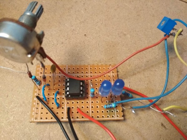

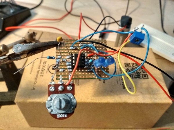

PostPosted: Sat Jul 14, 2018 1:34 am    Post subject: Reply with quote  Mark this post and the followings unread
Honestly, the crappiest looking building in the forum.
I have 5 different shots, but the attachment system is a bit strange... Last night I spent a good amount of time triying to debug but no avail. I have tried 2 full perfect 9v power sources, reflow all the conections check with the multi all the conections and possible bridges and test the separated components. Everything is OK, but it doesn´t work. Im about to desolder, trash the pcb and start a new one when I feel inspired. In the meanwhile there´s a lot of other builds waiting to happpen.
Your tri osc worked at the first run as I told you. Maybe I should keep breadboardind from there as you said

PostPosted: Sat Jul 14, 2018 2:56 am    Post subject: Reply with quote  Mark this post and the followings unread
dont worry about the look, it will be better the more you solder
i cant see so much on the photo, but the dil socket looks already tierd, did u measured directly on the pins of the chip if the supply voltage is there - or on the copper trace?
just before u start new u could try to solder that what u have tested on breadboard
some common things i could say
- things are easier when u leave more space eg. one hole between every component or bridge and one hole on to the side of the chip
- if u use the upside down method it is good if u bend little feets or hooks on the end of the component legs, easyer to solder and makes better connection
- clean there where u break the board, just go over with a cutter in 45° or a little file, sometimes there are tiny shorts
- instead of soldering in the resistors vertical i bend the legs like that, it is easyer to solder in and easyer to measure something when u need to debug

PostPosted: Sat Jul 14, 2018 3:42 am    Post subject: Reply with quote  Mark this post and the followings unread
Those LEDs look tres' cool, even before they're turned on!
Yeah, the great mistake has been to minimize the space and try to solder exactly as the diagram so I don´t get lost in what is what and where it belongs. Newbie error. Effecively reflowing and measurament is quite twisted in such a tiny space.
The dip socket is a 16 dip socket cutted in half (the 8 dips should have arrived 2 weeks ago) but I do measure directly from the chip pins and is working properly
Not sure about the upside method, I guess you mean in the non copper side. I thought in the beginning to do that, but was afraid of the mirror effect. Next building I will try like this. Thanks for your support Wink
@AlanP LOL, yep, it looks paleolithic at least!

I have rechecked all the tracks, possible bridges, multimeter all the things.
I declare this circuit to not work and to be a joke from Mr Woollastron. This or some kind of course.
Next!
 Filesize:  136.16 KB
 Viewed:  10 Time(s)
 Filesize:  136.16 KB
 Viewed:  8 Time(s)

Ok, I eat my words.
I have the original circuit flipflopping in the breadboard. So it definitively works. And the skew is just lovely. It changes the frenquency as well as the waveshape when the wiper is near the extremes.
I can confirm that 100nF is ok to go into slow LFO territory (various seconds per cycle). The 10k pot should be Logarimic to better finetune the slow LFOs.
Thanks for the patience and help! ;D
The second veroboard still not working. The only difference are the color of the leds, so the bug has to be in any trace or something. Will see.
I attach both circuits with some annotations for if someone finds it useful
Both circuits. The Tri OSC and the skewable LFO with pins numbered
 Filesize:  192.5 KB
 Viewed:  15 Time(s)
