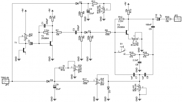

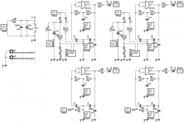

PostPosted: Thu Nov 08, 2018 6:40 pm    Post subject: Reply with quote  Mark this post and the followings unread
here's some
 Filesize:  54.79 KB
 Viewed:  233 Time(s)
 Filesize:  82.66 KB
 Viewed:  207 Time(s)
gasboss775
Joined: Jan 02, 2016
Posts: 214
Location: Scotland
PostPosted: Sun Nov 11, 2018 1:20 pm    Post subject: Reply with quote  Mark this post and the followings unread
Thanks J Chot.
I've seen those 4011 based circuits before but not the other one using discrete components, will need to give it a try.

PostPosted: Mon Nov 12, 2018 10:15 am    Post subject: Reply with quote  Mark this post and the followings unread
Those are psyingo, aka Phil B.'s schematics, btw
