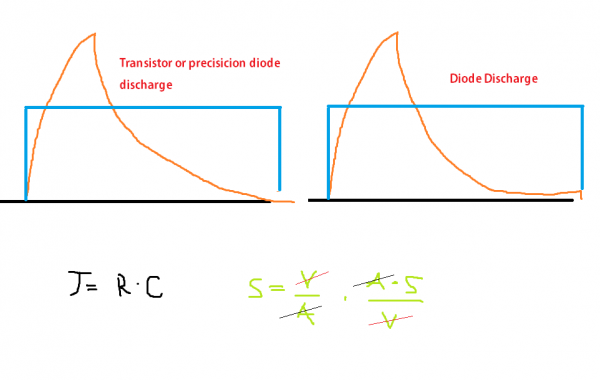

gabbagabi
Joined: Nov 29, 2008
Posts: 520
Location: will be back soon in Berlin by n8
PostPosted: Sun Jan 06, 2019 8:52 am    Post subject: Reply with quote  Mark this post and the followings unread
even the bloody simulator can reproduce this behaviour Smile
on the left side my "normal" AD circuit, the decay discharge is realized with a transistor, is represented by the red graph
rigth side, same circuit but "modded" to discharge-over-diode-thru-opamp, is the blue graph
you can see very good first the deformation and may more important that it takes much longer to reach zero, in this example it couldnt even reach zero
 Filesize:  66.91 KB
 Viewed:  98 Time(s)
