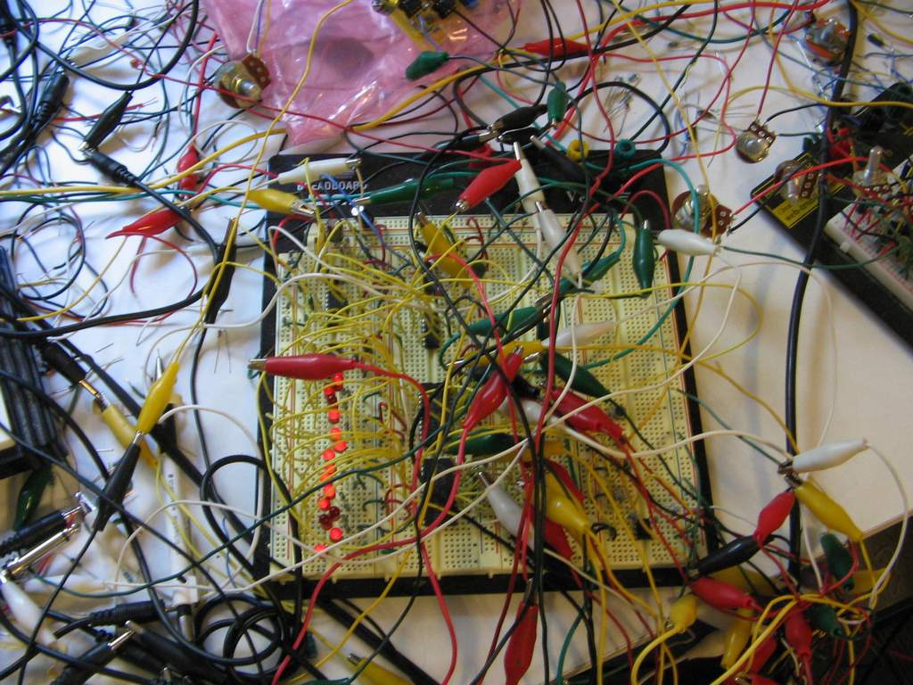

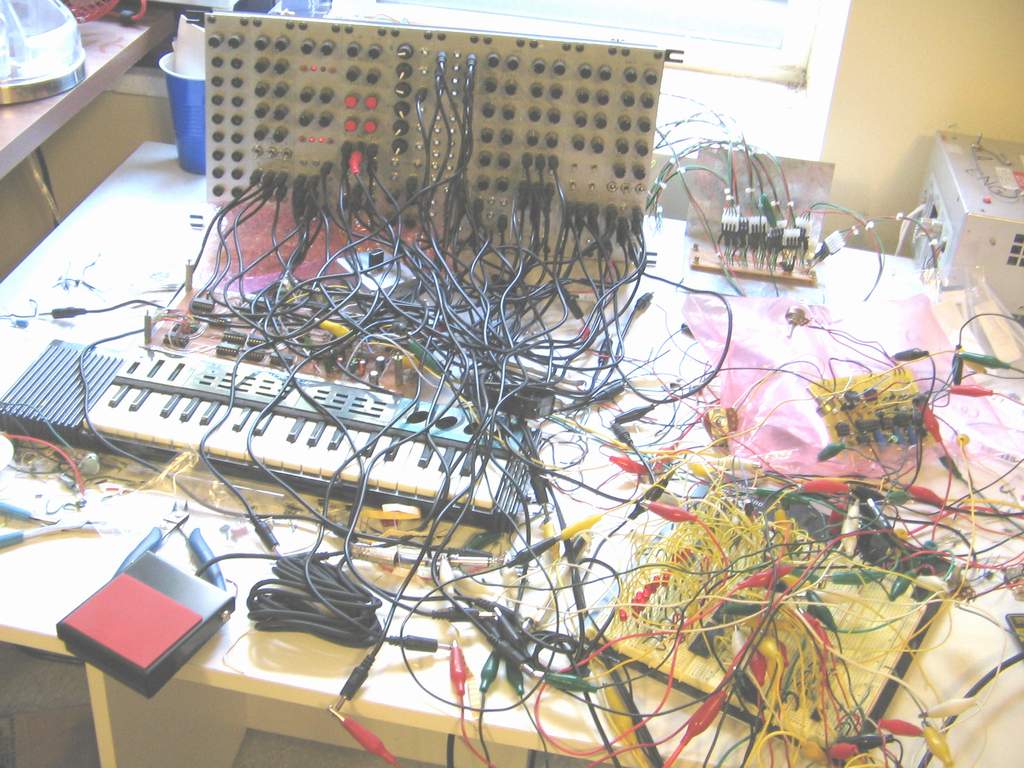

Some pics and a sample.
Pic of the Klee breadboard driving a KS-01 patch.
 Filesize:  125.89 KB
 Viewed:  764 Time(s)
The Model 2 Klee circuit on breadboard (with alligator clip position switches).
 Filesize:  136.17 KB
 Viewed:  763 Time(s)

Thanks Unca K and V-un-v. The breadboard does sort of look like something Pollock would have put to canvas. Very Happy

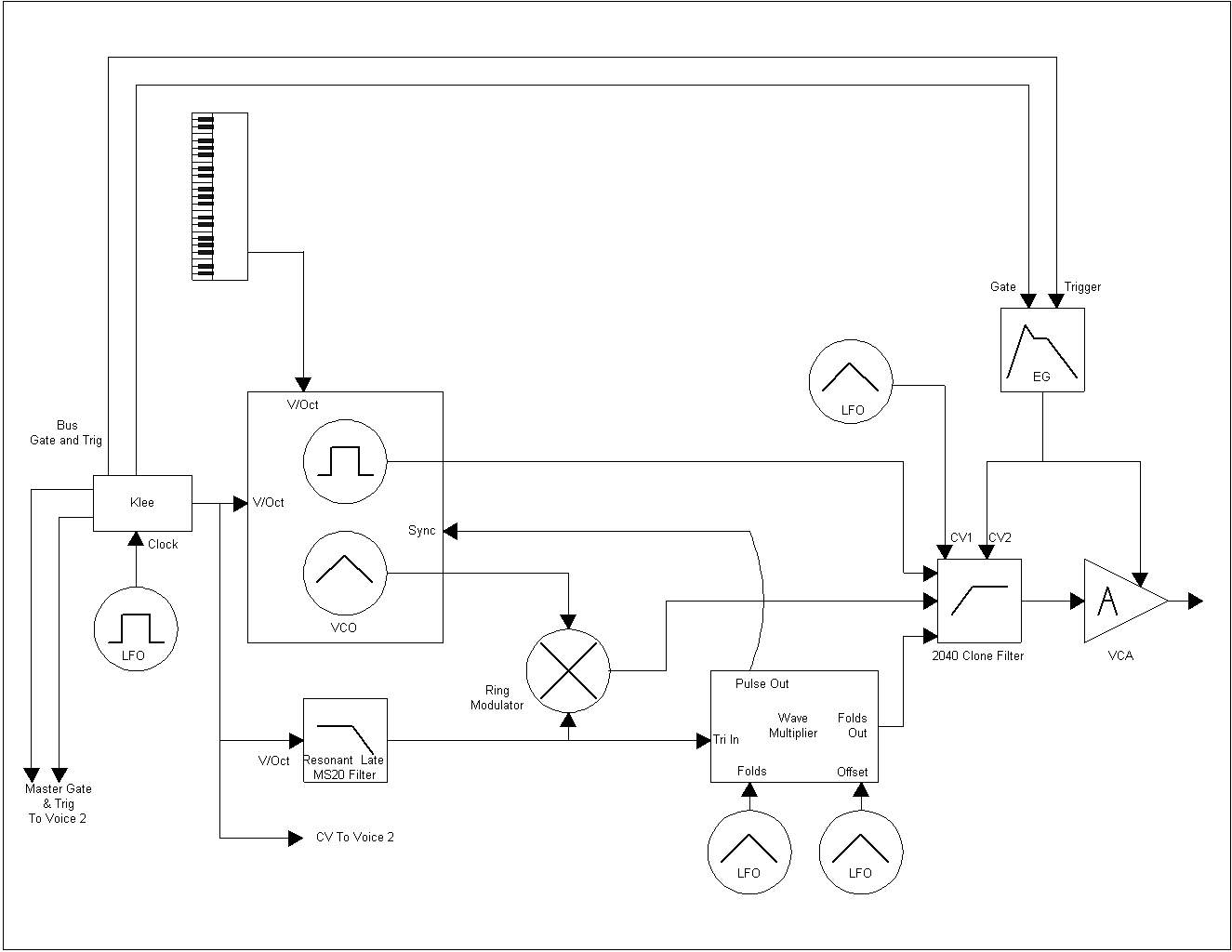

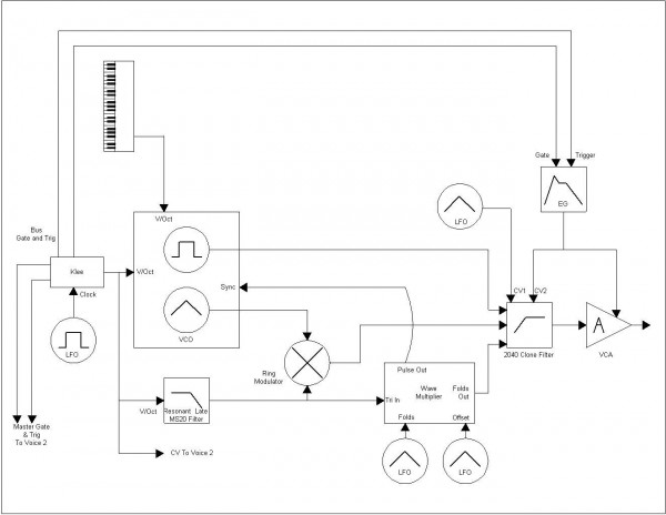

In this sample the Klee is acting more like a 'normal' sequencer - I didn't change any of its pattern switches throughout. Instead, I had it driving the four singal sources I used in the sequence, but also had the keyboard patched to the extra expo input of one of my Schmitz VCO3's - this is what provided the extra little quite notes heard throughout. The sequence was 'found' with a particular switch setup and the four Klee pots.
There was only one VCO (the VCO3) used for the voices. I used one half of my dual late MS-20 filter in self resonance as a signal source for the main 'low' part heard in the sample. It's patched through the wave multiplier. Before it was sent to wave multiplier it was multed to an input on my ring modulater. The triangle wave of the VCO was patched to the other input, and the ring modulated product of the two was used as the third signal source. The VCO, wave multiplied resonant MS-20 filter, and the ring modulated product of the two signals were patched into my 2040 clone filter, then through a VCO into my mixer module.
The fourth signal source was the Dark Star Chaos 2000 patched into the other half of the MS-20 filter in high pass mode (for a bit of wang), passed through a second VCA and into the second input of the mixer module. This is the atonal sequence that is faded out about halfway through.
The Klee was providing voltage control to the two halves of the MS-20 filter, the 2040 filter, the VCO and the DSC2000. It, in turn, was being clocked by a pulse wave LFO. The Klee was providing gate and trigger output to the EG controlling the 2040 filter and its VCA. The same LFO used to clock the Klee was providing a gate to the second EG, which was controlling the HP filter the DSC2000 was passing through and its VCA.
As mentioned before, the keyboard was also controlling the intial pitch of the VCO - this is what provided the variation in pitch of the rapid notes heard intermittently through the sample. Because the VCO was also controlled by the Klee, pitch changes would also occur when the Klee changed its control voltage. Towards the end of this sample, the Klee control was disconnected from the VCO, and the notes heard do not follow the Klee, though they are filtered and ring modulated with a filter and signal source that were both controlled by the Klee. In fact, the VCO is only heard mixed in at the very beginning of the sample - I then mix it out so that only its product is heard in the ring modulated voice. In the longer version, it starts out that way, then I mix in the straight VCO signal (sawtooth) to the mixer.
In the longer version, I start out with the direct VCO mixed out, then I connect the square output of the wave multiplier to the sync input of the VCO, mix in the VCO, disconnect the VCO from the Klee, disconnect the sync, then reconnect the Klee for variation in timbre and towards the end of that section is where I started this shorter sample. It was 3 MB, so I opted just to post the tail end of it.

Hey Romeo,
Wow - Twittering Machine - it does seem to fit. It would be nice if I could put that on the web page I will eventually do for this project. I'm sure there are massive copyright laws to put my butt in a ringer if I did, though.
I've uploaded an illustration of the bass voice - it's actually the same patch I've used in all of these samples, more or less.
The really low, steady part of the bass is a self-resonating Schmitz late MS-20 filter in high pass mode with no input. It's run through the wave multiplier, which has the folds and offset inputs modulated by two separate tri-LFOs. It's controlled by the CV out of the Klee. It goes from the wave multiplier triangle out to the 2040 filter. I used the MS-20 filter as a simple VCO, mainly because I was too lazy to hook up a second one.
The part that plays the high and low parts along with it is a more standard thing - a VCO controlled by both the Klee and my keyboard. The pulse wave goes straight to the 2040 filter.
The VCO triangle is ring modulated with the straight signal out of the MS-20 filter. This is fed to the third input of the 2040 filter.
When the sample first starts, I've got the ring modulated signal attenuated all the way down. Halfway through, I turn it up (the 2040 filter has input attenuators on each input). Then I hook up the pulse output of the wave multiplier to the sync input of the VCO, so the VCO gets synced to the self-resonating MS-20 filter. This is where more bom is put into the bombast for the second half of the sample. You can hear the higher notes get more gurgly/gratey from the ring modulation and sync.
The EG modulating the 2040 filter and the VCA is fired by two selected gates/triggers from the Klee gate bus. I flip on the 'merge' function for the breaks you hear in the sample.
The drummy/percussiony sound is controlled by the master gate and trig output (just follows the clock, so it's constant). That was the DSC2000 through low pass late MS-20 through wave multiplier grinder section through a VCA. The signal from the 2040 filter and the grinder output both went to my mixer module, where I control the relative level between the two signals before going out to the amplifier. The grinder, BTW, is what put that clicky, pitched sound on that voice, the one Robert mentioned.
Klee Kosmic Kalypso - I love it!
Cheerio,
Scott
