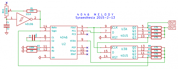

I found this schematic in an old book and I copied it down because it looked great while also looking very simple. I posted it in this forum because it runs on 5 volts.
I havent built it yet but i thought i'd toss it towards you guys to get some opinions on it. Is this feasible? To get this kinda of functionality from just some 741s?
Also, theres one input missing from an opamp in the schemy, i dont think thats a mistake i made copying it down, i really think it's left empty, is that bogus?

Shocked The Negative input for the pulse waveform's output, show be going to Ground. Smile
The circuit works wonderfully and IIRC is the same circuit that I used for my 2 very first modules in my modular synth, in July 2005. Smile I'd gone from the version of it that was published in Barry Klein's book.
( Laughing Edit #3 ) I'd originally run the 1st test module off of 2 x 9V batteries, hooked together to provide me with positive and negative 9 volt supplies, on bread board.
When I made the PCB for the pair of them, they ran perfectly fine unmodified, from my +/- 15VDC Power One power supply. (I'd used an LF347 for each of the LFOs.)

wait +-15 volts?
darrgg i could have sworn it ran off 5 volts!

That circuit will work fine on a single supply.
You just need to make a 1/2 supply "virtual ground" using a voltage divider like shown in figure 4 on this page http://www.geocities.com/thetonegod/opamp/opamp.html.
Then connect the opamp supply pins to V+, and ground (zero volts) and connect all the ground points in the schematic to 1/2V+.
You'll probably need a rail to rail opamp or one that's designed to run off low voltages to run it off 5 volts though, I don't think it will work with a 741.

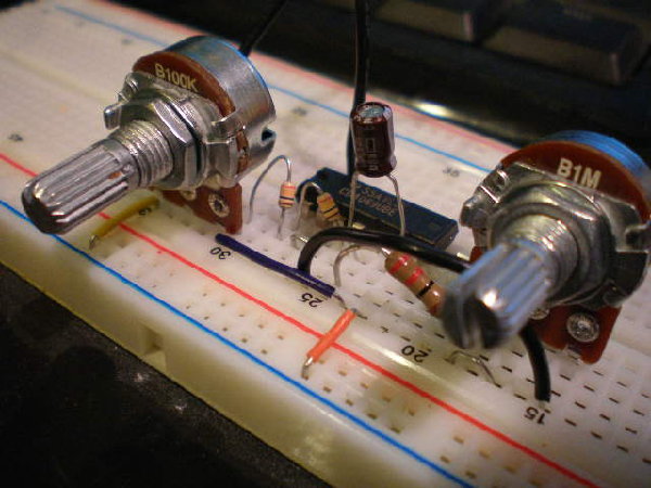

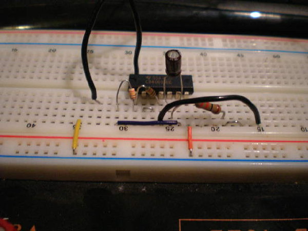

Ok I abandoned the 741 LFO and decided to try 4069 one since it seems easier.
How ever I don't have a 1.33uF cap but i do have a 1uF one.
BTW in the schematic it looks like a polarized cap, is this right?
Any Way I tried breadboarding it with the 1uf cap, i tried both polar and non-polar
but I can't seem to get it to work .
I'm using a single 9v battery, I got pin 7 to GRND and pin 14 to +.
I'm pretty sure I got something wired wrong.
Here's a couple of pics of my breadboard.
The 2 pots were kinda in the way so I took pics with and with out them.
 Filesize:  58.01 KB
 Viewed:  139 Time(s)
 Filesize:  49.21 KB
 Viewed:  127 Time(s)
JovianPyx
Joined: Nov 20, 2007
Posts: 1081
Audio files: 123
PostPosted: Sat Sep 12, 2009 8:39 am    Post subject: Reply with quote  Mark this post and the followings unread
The cap can be polar or nonpolar. 1.33 uF would give a lower frequency range. It should still work with the 1uF cap.
A 9volt battery should work.
All I can say is to really go over the wiring well, it's a simple circuit, nothing tricky at all.
Your output should come from the wiper of the rightmost pot and ground (or the negative side of the 9v battery).
What are you using to test it - to determine if it's working? If the frequency pot is set to high resistance, the output will change slowly, so you may want to turn it to a lower resistance.
