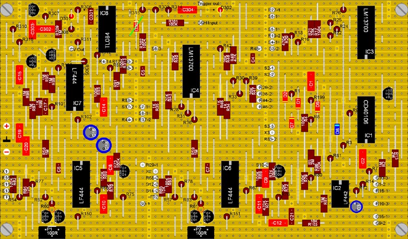

I think I posted a closeup of the S&H section on another thread, I can't remember now.
Anyway, here's a copy of V2.0 which includes the S&H and the 1V/Oct mods. The designators for the S&H are as per Ray's Schem +300. Note the orientation of the chips, and the three "weird" links. Two diagonal ones on front, and one long horizontal on back.
This layout now looks (and is) cramped in the top left corner, compared to some space I could probably steal from elsewhere. I'd like to refine it sometime, but it's one of those jobs I haven't gotten around to yet. Besides, at this stage I can gaurantee that the whole board (except the S&H) works perfectly. If you build it and the S&H works please let me know, as it may be a while before I get the chance to check it myself.
 Filesize:  164.52 KB
 Viewed:  20233 Time(s)

Here's the copperside view.
 Filesize:  172.06 KB
 Viewed:  20230 Time(s)

sweet! what about the underside? i mean... where the traces are cut.
note: i've never done a stripboard anything YET.

thanks for the welcome, i'm currently deciding whether to buy the pcb or to make a stripboard version... the latter can last right? i mean.. it's not meant only for testing purposes?

If I had the choice, I would go for Ray's PCB. Stripboard is a real chore- and is a sort of nostalgic thing used by people who are well into self harm (basically masochists!!!)

Uncle Krunkus can you explain me what is for the 2 circles that are
under the R60 and R61
the same for the Old StripBoard version
http://www.musicfromouterspace.com/analogsynth/SOUNDLABMINISYNTH/SoundLabStripBoard.html
i have not connected them to nothing ....
what are they for ?

I put them there to remind myself (mostly) that if the tempco mod is implemented (replaces R60/61) they need to be sat between the 2N3904s and thermally packaged somehow to get the best 1V/Oct tracking.
The red circle (in my mind) means the resistor and the 2 transistors are thermally "connected" if you know what I mean.

Uncle Krunkus wrote:
I s'pose it all depends on how much patience and how little money you have! Wink
I've always thought this stripboard technique looked interesting and useful when I see it in magazine articles from across the pond. And quite a bit more easily done than our Breadboard to RS-276-170 or 276-150 breadboard equivalent PCB, IMO.
But I've never found the raw materials anywhere convenient; and it seems a bit out of whack to MAKE stripboard from raw PCB stock ! Laughing
Anybody know of any reasonably priced sources for the stripboard and clearing tool?

PostPosted: Fri Jun 01, 2007 5:57 am    Post subject: Reply with quote  Mark this post and the followings unread
The stripboard I get comes from Jaycar Electronics here in Australia, but I'm sure you can get it in the states. For a clearing tool, or strip cutter, I use a 3mm bit in a pin vice. Very cheap, and easy. I haven't ever seen a tool which is specifically designed for cutting stripboard, but I have heard they exist.

mouser #854-ST6U, 854-ST3U... recently added. for cutting strips, i use a dremmel with the little ball rasp...

krunkus, Thank you also. I've got a machine shop; so I'll probably make a piloted counterbore style tool if I can get past the sticker shock Very Happy

What was the name of that stripboard layout program you use?
Is is shareware, freeware, or?
I don't remember seeing a link to get it in the earlier parts of this thread. Do you have one?
Thank you,
Randal
Posts: 4742
Audio files: 51
PostPosted: Sat Jun 02, 2007 5:23 pm    Post subject: Reply with quote  Mark this post and the followings unread
It's called Lochmaster.
Made by -
www.abacom-online.de
It cost me about AU$30-40
There's a new version now.

Does version 1 of this layout (the one that's on the sound lab site) include the 1V/oct mod? Or will I have to add it. I've decided not to do the sample and hold for right now.
Posts: 4742
Audio files: 51
PostPosted: Wed Jul 04, 2007 6:53 pm    Post subject: Reply with quote  Mark this post and the followings unread
No, the one on the SoundLab page doesn't include the 1V/Oct mod. The one further up this page does. It also includes the S&H in the top left corner. Just isolate which bits you don't need, and omit them if you don't want it.
Here's one: http://www.rsaustralia.com/cgi-bin/bv/rswww/searchBrowseAction.do?N=4294843874
I have no idea where you can find one retail...

Are there any lochmaster rst files for the soundlab ver2 that can be downloaded. I was not aware of creating stripboards with software until I came to this site. Its nice to see you dont need all those chemicals to build a sound effects project. It looks like lots of fun.
regards freewave
