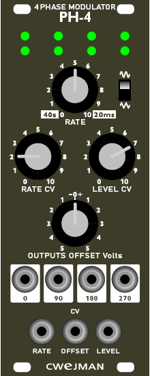

Cwejman PH4
Cwejman is also quite new to the modular world. The first batches of his modules are sold out, but more are on the way. In short, Cwejman will release eight new modules.
A-1 is an audio interface, with balances XLR connections. A-2 is an audio interface, with an opto compressor and envelope follower. There is also a voltage controllable compressor on the way, the VCFC. I have never heard of modules like that before.
PH4 is a barber pole generator. It gives four separate LFO outputs with a phase shift of 45 degrees. Used for feeding four filters, VCOs or phasers it gives an illusion of infinite rising frequency. I guess it is supposed to be used with two of Cwejmans SPH2, a dual (or stereo) 14 step phaser.
The Cwejman idea is to put many functions in each module, and have several pre patched internal connections, a bit like a semi modular module. One of the new units, the FSH-1, is for example, a frequency shifter, but also a ring modulator with an internal carrier generator. As the internal VCO can go down to LFO area, it can also work as a panning device.
There are also a voltage processor, a dual filter module and a dual VCA module in the new Cwejman series. Prize or date of release in not known right now.
Cwejman also plans to release a 19” rack of his own. The Cwejman modules are compatible with Eurorack, but as the printed board is parallel to the front plate, the depth is only a few centimetres. So the Cwejman rack will be a slim construction, possible to use as a desktop unit. I think it is a smart idea, as the main ingredient in all mighty modulars is just air…

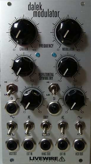

Livewire Dalek Modulator
Livewire and Plan B have now split their cooperation, and work from different sites. Livewire has three new modules in the pipeline, although none of is are for sale yet. The Dual Bisell Generator is two slew generators, with adjustable slope and time. The Dalek modulator is two VCOs with cross modulation and one ring modulator in the same unit. Sound examples are not yet on http://www.livewiresynthesizers.com/forums.html?op=modulators but I guess it can produce some really wild and nasty sounds. The Vulcano modulator has the same principle, but uses two VC LFOs instead. Internal processing gives 10 parallel outputs, as sum, difference, minimum and the common wave forms.
