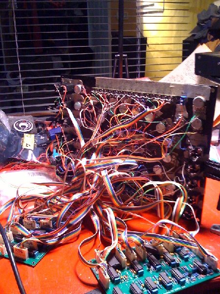

So, all done wiring the Klee! Thanks everybody for this amazing sequencer. I have been playing with it using the step button and it really is amazing. If only I could load a pattern or have it run by itself... I seem to be having the same trouble as mentioned earlier by Photon. I have the unit on and all 16 led's light in sequence and then they disappear in sequence, then light up, then... This is while I manually step with the step button. I'm getting cv out and gates and triggers as well. I have been trying to clock it with an lfo and another sequencer, but it just won't respond, though once I plug anything into the clock jack the clock led turns on. If I cycle the unit off and then on I get sometimes the aforementioned led cycle and other times a random display, but the load button in either case does not change this. I've tested the button and continuity is made when pressed. I'm wondering if anything more was found out in Photon's case. If anyone could help me figure this out it would be much obliged. Thanks. |

Okay. Pin 5 of U2 on the digital board is showing about 12.40 v and when I press load it goes down to about 12.33. Pin 6 goes from 0.00 to 0.07 when the button is pressed. Any ideas? |

KEYKEYEYEKIT wrote: | So, all done wiring the Klee! Thanks everybody for this amazing sequencer. I have been playing with it using the step button and it really is amazing. If only I could load a pattern or have it run by itself... I seem to be having the same trouble as mentioned earlier by Photon. I have the unit on and all 16 led's light in sequence and then they disappear in sequence, then light up, then... This is while I manually step with the step button. I'm getting cv out and gates and triggers as well. I have been trying to clock it with an lfo and another sequencer, but it just won't respond, though once I plug anything into the clock jack the clock led turns on. If I cycle the unit off and then on I get sometimes the aforementioned led cycle and other times a random display, but the load button in either case does not change this. I've tested the button and continuity is made when pressed. I'm wondering if anything more was found out in Photon's case. If anyone could help me figure this out it would be much obliged. Thanks. |
Congratulations on making it this far. Can you tell me the make and type of 4034s you have? If you change to 2x8 mode does it do anything different?
Also if you put a single step pattern in (first pattern switch on) and load and enable clock, does it simply run through a single 16 pattern cycle and stop?
Relevant pages of the schematic are 2 and 3. On page 2, U3 pin 4 is your clock's output, you should see a clock pulse with your scope. There isn't a lot of logic involved after that point, hence asking about the 4034s, if you've read a bit you'll know there was a bad batch of them which are responsible for a fairly high amount of problems.
Also check U9, pins 4 and 14. They should alternate in 1x16 mode.
Does invert B do anything to influence the outcome? it should turn each light in 9-16 on progressively if you have entered a single stage pattern in stage 1.
Also, if you single step does it work ok?
ok I just read your other post too, check that load switch. It should have pulled that down to logic low. _________________ Garret: It's so retro.

Thanks, I'm really excited to have this wired. Was hoping to play it at a show this weekend, but i ear perhaps i jumped the gun on that bit of ambition.
The make and model of 4034's is TI 8CA1638 CD4034BE. |

KEYKEYEYEKIT wrote: | Thanks, I'm really excited to have this wired. Was hoping to play it at a show this weekend, but i ear perhaps i jumped the gun on that bit of ambition.
TIs are fine. It sounds like it attempts to load. The alternating stuff sounds like you have invert B on, which might be indicative of a further problem, or you just have some switches backwards.
Can you check U2 again, all ins and outs, and see if it's actually working. Have you got a scope instead of a DMM, you'll want to look for pulses. _________________ Garret: It's so retro.

Also, the step button works without trouble. And would it be relevant to report that when I plug in to the ext clock jack it turns on the clock led and gate led's and when i remove the plug from the jack it stays on until I cycle power. |

KEYKEYEYEKIT wrote: | Also, the step button works without trouble. And would it be relevant to report that when I plug in to the ext clock jack it turns on the clock led and gate led's and when i remove the plug from the jack it stays on until I cycle power. |
The step button does not use U2 in its circuit, which is why I suspect U2, which is common to the other malfunctioning circuits you are mentioning.
Another test is to try to manual step your way through a Bus 1 Load. If that works, I would have another look at U2. _________________ Garret: It's so retro.

I have a signal getting to U5(4013), but nothing coming out of any of the other pins there. Could this be the problem? |

To back up a bit, bus 1 load did not work when stepped. I checked the path of the load button and the pulse continued into the 4013, but then did not exit from any of the other pins. All other IC's seemed to work fine until that point. I just want to see a proper load, then I will move on to the clock issue. |

KEYKEYEYEKIT wrote: | To back up a bit, bus 1 load did not work when stepped. I checked the path of the load button and the pulse continued into the 4013, but then did not exit from any of the other pins. All other IC's seemed to work fine until that point. I just want to see a proper load, then I will move on to the clock issue. |
So you saw a pulse at U3 pin 10? Even if you press manual load switch? hm.
Well, check your traces on the board. It's a complicated build and one blob of solder can make trouble. It is entirely possible that you have one or more bad chips, which will complicate debugging. However, if you see nothing coming out of U5 pin 1 when pulses are present on pin 3, it implies either the 4013 is fried or something else is holding it up or down. U2, however, is involved in that part of the circuit now I look too, so that might still be the problem... still looks to me like everything you're having a problem with has something to do with U2. _________________ Garret: It's so retro.

Quote: | It's a complicated build and one blob of solder can make trouble. |
Yes, the problem could be along those lines. IIRC, on Photon's Klee, a couple of the feed-through's had become disconnected from the traces.
A good, tedious session of point to point resistance checks might help.
E-Rex is quite likely right also with the reason why the LEDs alternate between on and off.
Another problem would be that the clock LED should go off if no signal is applied. But, one thing at a time.
If this is leading nowhere fast, you can send the Klee to me and I'll get it working - no one should go through the hassle of building one and then have it go nowhere. Just return postage is all I would require (just to keep the wife off of my back regarding expenses). It would be a pleasure for me.

That is an UNBELIEVABLY nice offer. I want to make sure I exhaust every possible thing I can do on this end first though. Especially after such a kind offer as that.
Also, I swear the plan is to clean up my wiring after I get it running...
Traded out all the chips in question, and I am still having the same issues.
Then...
I fed a clock signal into the clock jack, and when I flipped the clock in switch, it stopped my sequencer. When I switched it off, my sequencer went back about its normal LED chase sequence life. Now, I never saw anything instructing me to do so in the Klee build, but I thought I should ground the incoming clock switch to digital ground. Is this not something that should be done? Is this one of my very likely to be many problems in the build?
I have obviously gnarled this thing up in all sorts of foolishness. I'll do the point to point tests, though I leave for tour in 2 days, so it will probably have to wait for a bit.
Thanks to the both of you for your help! One day this thing is going to SING!

That wiring job doesn't look any worse than most of the ones we've seen.
Scott is awesome, in case you never noticed.
Good luck. If you get a chance please check your wiring. The wiring instructions are quite explicit so if there's a question, post it here. _________________ Garret: It's so retro.
