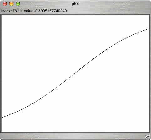

dewdrop_world
Joined: Aug 28, 2006
Posts: 858
Location: Guangzhou, China
PostPosted: Wed Jul 11, 2007 4:42 am    Post subject: Reply with quote  Mark this post and the followings unread
No, not tan, tanh - hyperbolic tangent - http://mathworld.wolfram.com/HyperbolicTangent.html
In distortion you want low-level input to be basically unchanged, but higher amplitude values should be "squished" lower. So the transfer function should have an s-curve, with a higher slope in the center and lower at the edges.
The normal trigonometric tangent has an infinite slope at pi * x where x is 2*i + 0.5, so it's not a good candidate for classic distortion (though it may be good for other outrageous sounds).
Graphed in SuperCollider, tanh looks like this, ranging from -1.0 to +1.0.
SC also implements y / (1.0 + abs(y)) as a primitive for distortion. Nice sound, actually.

kijjaz
Joined: Sep 20, 2004
Posts: 765
Location: bangkok, thailand
PostPosted: Wed Jul 11, 2007 2:38 pm    Post subject: Reply with quote  Mark this post and the followings unread
Wow.. dewdrop_world ,
y / (1 + abs(y)) ! .. that's one idea i never tried for distortion!
It looks so simple.. I'm gonna hear and see it distorting a sine wave right away...
That's a lovely function.. The result won't go outside -1 to 1 range also..
The slope at the origin is also equal to 1
note:
dy/dx of x/(a+abs(x)) = 1/(abs(x)+1)-x^2/(abs(x)*(abs(x)+1)^2)
That makes me wanna tryout with this one also..
y / (1 + y^2)
From looking at the graph, i suspect it'll produce an interesting modern distortion sound if y's amplitube's going over 1.
Me trying out x/(1+|x|) drive with SinOsc
