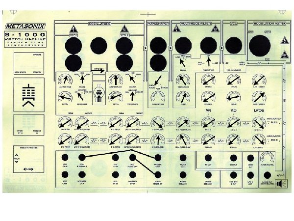

Then I will describe the first simple patch.
Put a patch cord from VCO1 Audio Out to VCO2 CV In.
Turn off Sync
Make sure VCO1 is in tune
Adjust VCO2 frequency until you find a good harmonic.
For more fun, add modulation of VCO2 from the AD envelope generator.
Try different combinations of waveforms for VCOs.

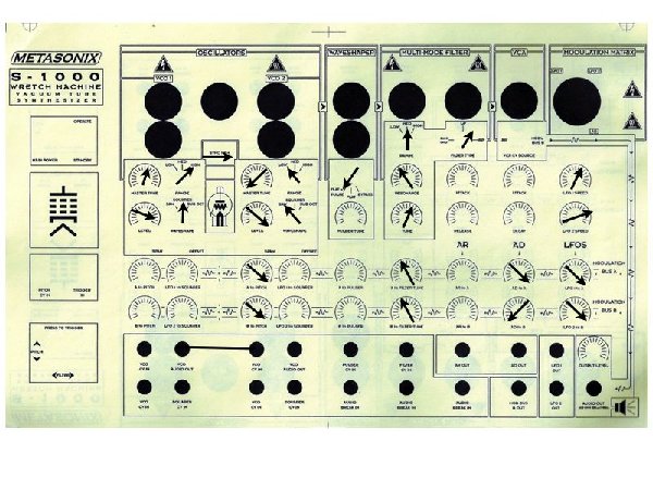

Here's another example of using FM to get extra timbre. This time, VCO2 is modulating the filter at audio FM speed. In this example, VCO1 is sync'ing VCO2, and VCO2 is tuned down about a 5th or so, but you can play around with that. The important part is to drive the filter's CV with audio. As touchy as the envelope generation is on this instrument, the response to modulation is really very good. Play with the filter range and type.
 Filesize:  100.07 KB
 Viewed:  395 Time(s)

PostPosted: Mon Nov 12, 2007 1:42 pm    Post subject: Reply with quote  Mark this post and the followings unread
Hmm, never thought of trying that. Thanks!
I would not think the Vactrol in the filter could respond fast enough to be modulated with audio.....need to try this.

PostPosted: Mon Nov 12, 2007 1:51 pm    Post subject: Reply with quote  Mark this post and the followings unread
It does not seem to like high (>2-3k) frequencies, but mine takes low and midrange quite nicely, and I get a fairly strong artifact from it. Let me know if you can reproduce it. I'll record it if you want to hear what mine's doing.
