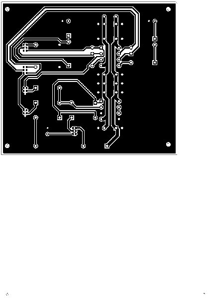

I've put haxters/raywilsons gain stage into cad and come up with a starting point for single layer pcb (with 3 jumpers) Its my first attempt at board design so I'll work on it more till I present it
When I have done as best I can i'll post for comment and advice.

Hey,
So I have come up with a single sided layout of the schematic Haxter posted.
Its the very first board I have ever attempted to design and has taken the best part of a day even with this simple little schematic its quite a challenge to work out single sided fun though...I think ...so I was wondering if you kind people (haxster if you have a moment) could check it out and advise me. I have done some learning about pcb layout so hopefully I have got some way and avoided the major pitfalls...
Anyway this is stage 1 the simple part...next comes the actual vcf that going to be fun!
Wilson Last edited by handsfelloff on Wed Jan 28, 2009 3:30 am; edited 2 times in total |
handsfelloff
Joined: Sep 01, 2008 Posts: 24 Location: uk
Posted: Tue Jan 27, 2009 11:57 am Post subject:
single side pcb layout first attempt! Let me know if I made any obvious rookie errors
wilson
