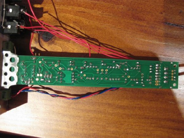

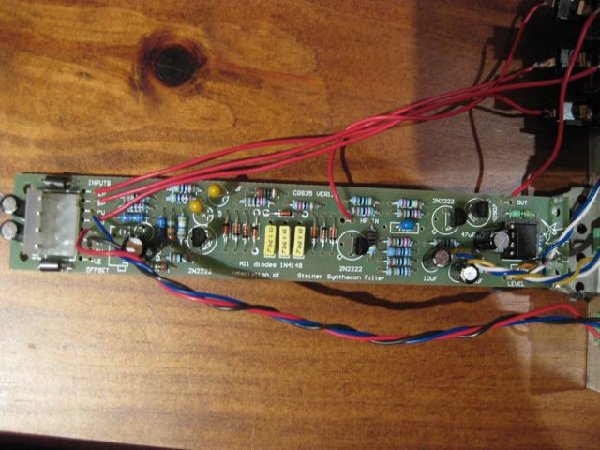

PostPosted: Wed Dec 15, 2010 4:06 am    Post subject: Reply with quote  Mark this post and the followings unread
Yes well I know it looks like a pretty bad job, and it is (my first build since I was about 14.. since this build I have successfully put together about half a dozen modules) - the resistors are in either way (I didn't realise the convention of keeping them left to right) and I was probably a bit heavy on the solder.
Also, one of the pads lifted when I gave it too much heat so there is a blobby direct solder link between the leads of a resistor and a diode. Embarassed The multimeter says it's ok, and I have gone over the rest of the board thoroughly to check for bad joints or bridges. None found.
Also, since I wired it from the top it might be a bit hard to see all the components. Anyway..
Also note that I have taken out the trim pot and made the changes you suggested earlier.

otherunicorn
Joined: May 11, 2008
Posts: 136
Location: Australia
PostPosted: Wed Dec 15, 2010 12:56 pm    Post subject: Reply with quote  Mark this post and the followings unread
There is a limit to what I can tell with these photos, but considering that, I can't see any problems. If you want to, you could substitute 2N3904 and 2N3906 for the transistors, though they would need to be installed backwards to the ones you have there (though I would check the transistors in a meter before installing , because there are some that have reversed pinouts).
If you have a friend that knows anything about electronics, have them give it a look-over. They may see something that you miss every time you look.

PostPosted: Thu Dec 16, 2010 1:48 am    Post subject: Reply with quote  Mark this post and the followings unread
Did that, and.. Great Success!!
Sounds just like it should! Very nice! Just needs a minor mod as you have previously suggested, to get oscillation with the new transistors.
So I guess there was something up with the 2222As I originally had in there..? Whatever the case, I'm just glad it's working now!
