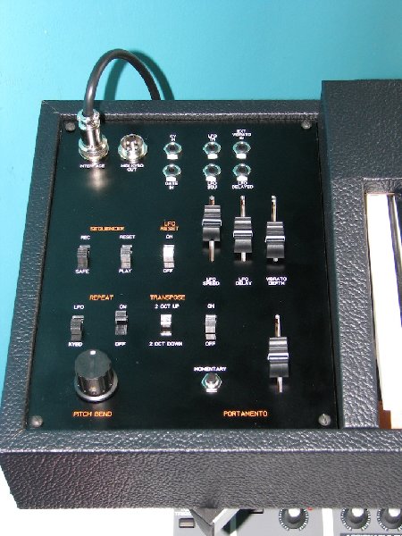

I thought it was time to build a keyboard for my modular, and being a bit of an ARP freak, I based it on the 3620 Keyboard with a few modifications.
The keyboard mechanics and midi PCB is from an M-Audio 49e, which feeds a Doepfer MCV4, but I'm only using CV and Gate at the moment.
The LFO, Delay, Kbd repeat, Transpose, Pitch Bend and Portamento were taken directly from the 3620 schematics (although the only copy I could find was very low resolution, and I could only guess at some of the component values).
I added a very basic version of Alain Coupel's PIC Sequencer, which is triggered from the LFO or keyboard gate, and also a switch to disconnect the LFO reset trigger.
Unfortunately, in my excitement to get the build done, I sent the wrong file to Front Panel Express... The correct file had a few extra graphics for slider levels and a few additional holes for the Doepfer CV2, 3 & 4 outputs - never mind, silly mistake that can be corrected later.
Just needs a coat of black paint inside the case to finish... bare MDF is not a good look

You're out of control, this is amazing. I'd love to hear more about the making of the cabinet/tolexing. I've started to build some simple cabinets that I'd eventually like to tolex, and could use some pointers.

I second this. The tolex is a nice touch.

Hi Eric, I started another cabinet just before you sent this message, but I'll take photos as I go along and try to get a simple guide together. I'll either post it here or put up a link to my site as soon as I can. _________________ Kronos 2-88, Kronos 61, Studiologic Sledge V2/SL, Broadwave ARP 2600EX, Broadwave 18U ARP based Eurorack Modular, Broadwave Minimoog Clone, GEM S2 Turbo.

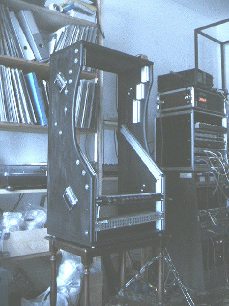

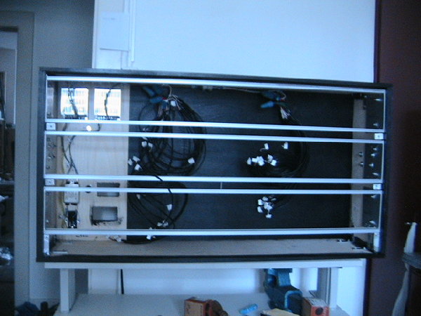

not built any modules the last two month, but two racks.
another euro-modular, and a 19" Rack to replace the old studiorack
Description: |
eurorack with ventilation slots cause i run the modules so hot |

Description: |
the new rack for my 19" mixer |

hey ,thats a nice arcade rack |
