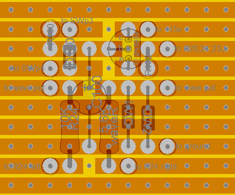

After quite a bit of head scratching trying to figure out how to incorporate my chosen mods into the "B" section of my Bass++ I think I've finally come up with a solution. As I mentioned before, I wanted this section to be my primary kick drum module, so wanted to incorporate Doug's frequency lowering mod (C2 change), plus his waveshaper and Jumunius' "pitch bump". The C2 change was easy, but how to get the other two installed and provide for the wiring to the panel neatly really had me stumped. I decided on a little stripboard daughterboard (about 0.8" square) to hold the components for both mods and provide for the panel wiring in one fell swoop.
If you look at the pictures you'll see that the bottom 4 strips handle the wave shaper mod. By moving R24 from the Bass++ PCB to the daughterboad I get to use the R24 pads both to connect the mod to the B++ and if I use headers instead of wires for the connections they would float the daughterboard above the B++ (with a little support glued in at the other end). Then again, maybe that's not such a good idea, as I'd have to unsolder it from the B++ if there's a problem that requires access to the stuff under it... maybe just use wires and secure it to the top of the LM13700 with a wire tie and some insulation between the two? Thoughts, anyone?
Moving forward, the top 3 strips make up the pitch bump mod... C100 gets its ground from the waveshaper ground strip, but other than that, all the pitch bump stuff is on the upper 3 strips.
So there's my intended solution... if any of you have a better idea, please, by all means, let me know. Unless someone tells me this is not a good solution and suggests an alternative I'll probably be soldering this up this weekend. (I'd also like to hear how other folks have incorporated their mods.... there's much to learn here, that's for sure.)
Seems ok but things are a little tight in places. For example, there are a lot of trace cuts around the transistor. You might move everything to the right of the transistor over by a column or two, just to make sure you have room for soldering. Stripboard can be a little messier, easier to make solder bridges in my limited experience. Also, why not line up your wiring into columns -- you could more easily use headers to easily connect/disconnect in this case.
...if I use headers instead of wires for the connections they would float the daughterboard above the B++ (with a little support glued in at the other end). Then again, maybe that's not such a good idea, as I'd have to unsolder it from the B++ if there's a problem that requires access to the stuff under it...
Yeah, that might be a hassle, I would recommend doing this in a way that is easier to detach. You want to be able to easily test and tweak as necessary. Plus, if you are still working on your C and D sections, you want to be able to work with the main board easily, without anything in the way. What if you decide to mod C and D? Things could get messy fast. And if you are relying on the wiring itself to hold your daughterboard in place, that sounds like a long-term stability problem, although the db will at least be light.
If you're not making all 4 voices you could do what I did and use one of the spare layouts to mount your components. The pitch bump mod could easily use the decay circuit from section D, while you fly wires to and from it under the board. But I assume you're making C and D from your description, so...
It sounds like part of the problem is you don't have an easy place to physically mount your daughterboard. It's hard to troubleshoot that without knowing what your enclosure looks like. I generally use mounting brackets made out of cheap sheet metal pieces from a hardware store, and they are big enough to attach a daughterboard off one end. Can take a pic later.
Then to connect between boards, you should probably use the same sort of interconnects on your db that the Bass++ recommends for its panel wiring. That way you can disconnect everything from the main board to work on future sections.
As for the main board, you may be able to find sufficient room to drill 4 holes (on an edge?) and mount a header there, flying wires under the board to it. More likely, you just fly wires directly to your db interconnect and tie them off with wire wraps as best you can. As long as one section is disconnectable you will be happy.

PostPosted: Sat Sep 10, 2011 1:13 am    Post subject: Reply with quote  Mark this post and the followings unread
You're absolutely right, Jumunius... I should have thought of those things in the first place. I moved some things around on the stripboard, taking advantage of the several unpopulated strips, and wound up with a layout that required only a single strip interruption (under the transistor, which now has a little more space, as you can see). I've actually become quite adept at soldering stripboard and have pretty much eliminated the problem of solder bridges. When I'm done with one I usually clean the strip side with alcohol (I use no clean solder, but the flux still leaves a slight residue that can be easy to mistake for a solder bridge if the light hits it just right) then I take a good look at it with a stereo microscope to verify all the solder joints... takes a little more time but eliminates headaches down the road.
Right again... This is why I asked for suggestions. Smile As you can see from the updated pictures I've installed a header for the connection to the main board. The one missing terminal polarizes it so it can't be connected backwards... I should have done this in the first place.
That would be great... I really learn a lot from seeing other peoples' work. As for enclosure, I'm planning on keeping all my modular stuff in the same format... I got started in it with a dot-com entry system (only 3 installments left... yippeee Cool Cool Cool ) and have purchased a number of panels from Bridechamber in either dot.com or MOTM format for modules I'm building. The game plan for the Bass++ is to do a single panel for all 4 sections. I'll have plenty of room back there to mount this db, although I still think I'll look for a way to physically mount it to the main board.
I have some breakaway 36-pin headers that I bought just for these kinds of situations... very handy and cheap to boot. I'm thinking I'll do all the wiring on the main board on the component side and then maybe just tie off the db to one of the other headers on that section... that may ultimately be the simplest approach. I'll know better once I've built the db and can wave it around the main board to see what will work best. I'm sure a reasonable solution will present itself... you know, one of those "light bulb" moments. Wink
Anyway, here's the R2 layout.... thanks so much for the input, it is truly appreciated.

Hey Marvkaye -- I haven't had a chance to give a serious look but in anticipation of V3, I should say -- you will need at least an extra column of space for your headers, 2 might be nice just to give yourself a little extra breathing room. Most headers I know of take up an extra column on either side.

PostPosted: Sat Sep 10, 2011 1:03 pm    Post subject: Reply with quote  Mark this post and the followings unread
I know what you mean... I use the headers with the wider base on full size PCBs, but with these little daughter boards I like the teeny guys. The first photo below is of a bipoolar LED driver that I built for Tim Servo's LFX LFO module (discussion and stripboard layout at http://electro-music.com/forum/topic-49449.html). You can see the two tiny headers for the LED outs hunkered in between the transistors and trimmers. I'll use little dots of paint on them to match the wire colors for polarity.
And finally, the R3 version that I think accommodates everything. The small header is for all the connections to the main board, the large one for everything that goes to the panel. This way the modifications are completely removed from the circuit when the headers are disconnected... should help with troubleshooting and mounting as well. I'll cut off the end pin on each of the headers and will use 1-pin wider plugs for polarity. I guess all that's left is for me to get soldering now. Thanks for all the assistance along the way... it also gives me some new standards that I can apply to future projects. Cool stuff. Very Happy Very Happy

i got it to work. there is an error in the parts overlay of PickNick's PCB layout.
follow-up over at Muff's:
http://www.muffwiggler.com/forum/post-969257.html#969257

i shall use his pcb then and check the parts from the TH schem?
cheers

yes. it was a bit of a pain to decipher the part numbers, but that's the way to go. picknick's design already includes the simple but cool diode waveshaper mod outlined here: http://electro-music.com/forum/topic-40457.html
i strongly suggest to clone the envelope and use one for pitch and the other for the VCA. instructions for this can also be found in the post linked above. the design gets a tiny bit more complex, but it's very rewarding. without separate pitch envelope i found the bass++ rather dull (as stated in the post over at muff's)
EDIT: erhm we ARE already in the "mods" post Embarassed so just read the posts in this thread...
