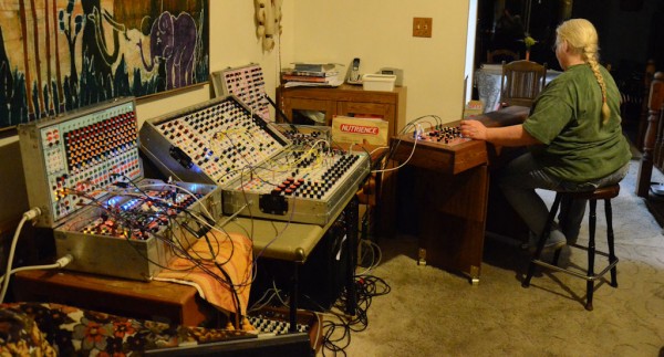

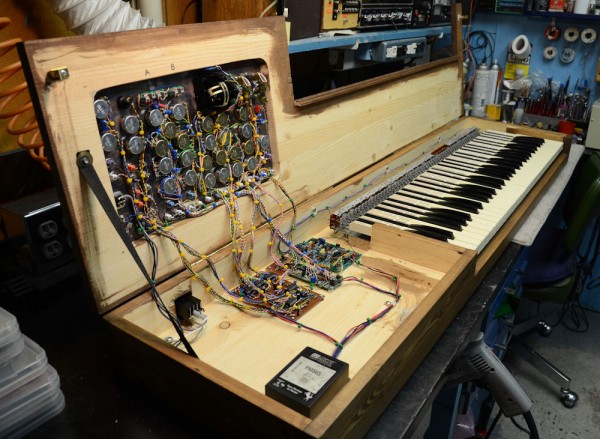

PostPosted: Mon Jun 13, 2011 8:19 pm    Post subject: Completed Keyboard Controller Reply with quote  Mark this post and the followings unread
My Keyboard Controller is now completed and I'd like to share the finished product with everyone. I still find it amazing that everything I hoped to achieve with this Keyboard Controller (thanks to the designing and modifications of The Peasant) has been achieved.
I was a little worried about whether I had chosen the correct placement for the controls and how smoothly everything would work when it came time for making music - but, for me, it all works smoothly and effortlessly.
The first picture below shows the circuity and wiring of the completed Keyboard Controller and the second picture shows my Controller hooked up to The Peasant's SynthCase system (he has to share it now!!).
If you would like to see more detail, feel free to go to my webpage: http://www.celticpeasant.com/physical/keyboard/keyboard.html
I wanted to thank everyone again for their advice! Very Happy
