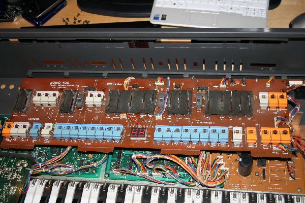

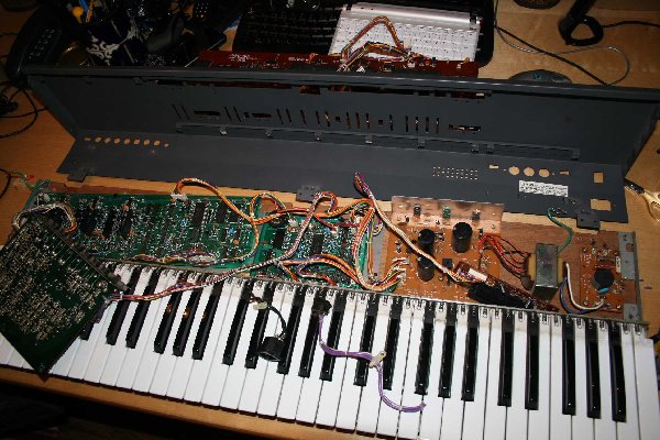

PostPosted: Sun Apr 04, 2010 1:11 pm    Post subject: Opening her up and de-soldering voice chips, wave and 662 Reply with quote  Mark this post and the followings unread

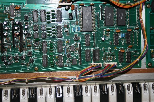

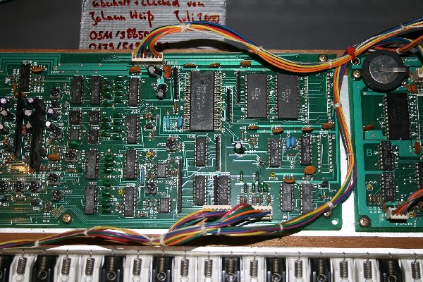

Why did i undertake this operation to begin with? First of all, two of my voices did not work. The sub-osc did not work either, nor did the white noice. I got the juno off Ebay from a german seller and it had seen better days (to say the least). The top-cover was very rusty (not kidding) and most things were loose (bender board for example). I had one of these over 20 years ago which i bought almost new with its original casing, etc. When the D50 arrived i went digial all the way and sold it (which i have regretted since). I then found this and purchased it, not knowing exactly what i was in for..... Smile
The first thing i did was to extract the main board where the voice and wave chips are. There are 6 voice chips and 3 wave chips:
(Voice-W-Voice-Voice-W-Voice-Voice-W-Voice) counting the rightmost voice chip as number #1, etc (from right to left, 1 to 6)
Before the "surgery" begins :-)
 Filesize:  3.17 MB
 Viewed:  140 Time(s)
The lid is open....
 Filesize:  385.57 KB
 Viewed:  166 Time(s)

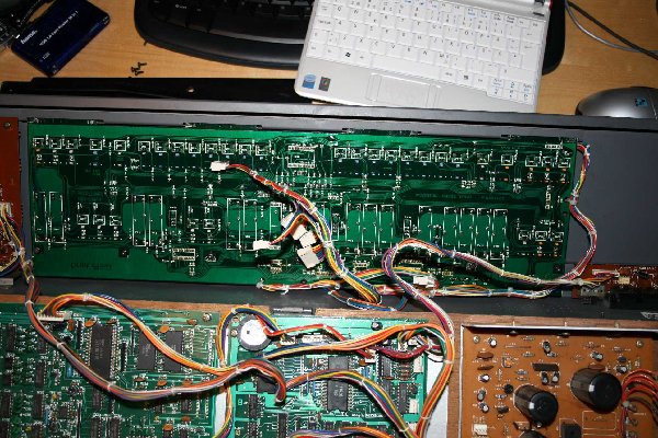

PostPosted: Sun Apr 04, 2010 1:15 pm    Post subject: Reply with quote  Mark this post and the followings unread

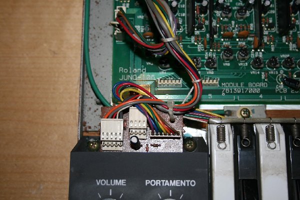

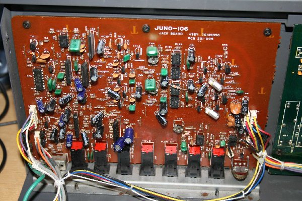

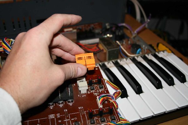

While disconnecting everything, it is very wise to also document where the wires and stuff go...
 Filesize:  278.22 KB
 Viewed:  130 Time(s)
 Filesize:  537.48 KB
 Viewed:  130 Time(s)
 Filesize:  3.46 MB
 Viewed:  121 Time(s)
 Filesize:  564.13 KB
 Viewed:  129 Time(s)
 Filesize:  460.09 KB
 Viewed:  138 Time(s)

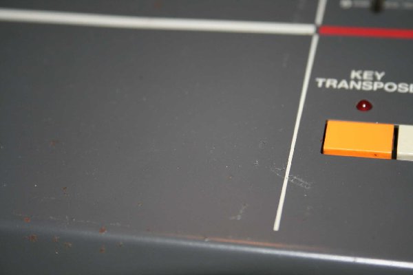

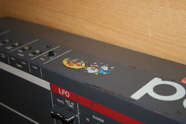

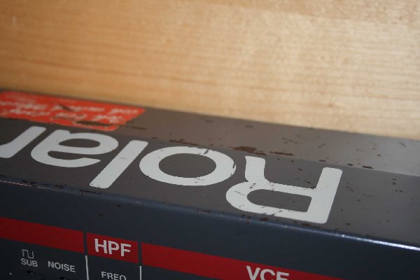

After doing the same for the other voice chip and the faulty Wave-chip (which was the cause of the missing sub-osc) it was time to swap the old rusty cover for the new one that i purchased from LektroiD.
First pictures of how the old rustbucket looked like:

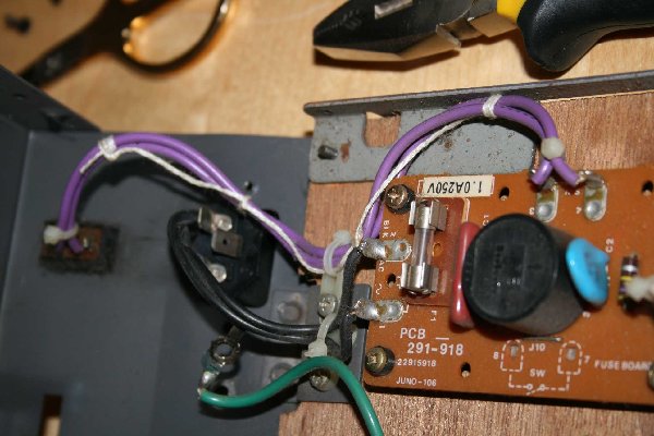

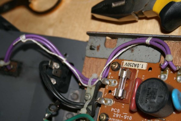

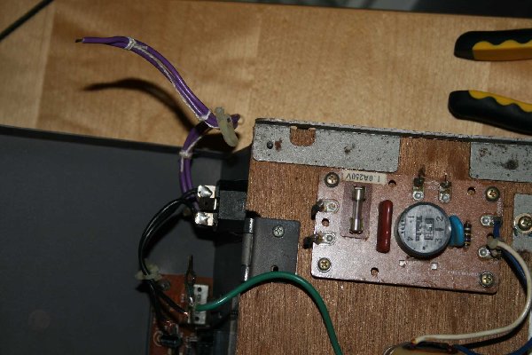

To swap the cover, you have to extract the jack board, midi board and control board + take out the power supply plug, etc. Did i mention that photo-documentation is key Smile
Also, in my case i found it impossible to get the power plug out so i cut the wires and re-soldered them when the new top-cover was in place again.
 Filesize:  278.02 KB
 Viewed:  126 Time(s)
midi-board
 Filesize:  129.22 KB
 Viewed:  119 Time(s)
The panel board when extracted from the top-cover
 Filesize:  267.09 KB
 Viewed:  129 Time(s)
The fuse board. Soon to be cut to get the power-plug out...
 Filesize:  145.96 KB
 Viewed:  118 Time(s)

Solder back the power leads (be extremely careful not to swap the leads by mistake...)

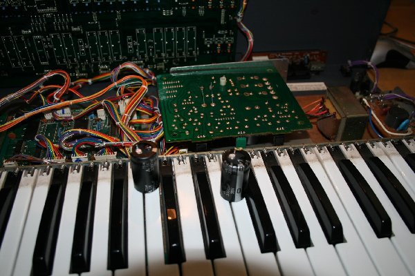

 Viewed:  114 Time(s)
25 year old caps, big and dry vs. modern counterparts (same specs)
 Filesize:  296.73 KB
 Viewed:  108 Time(s)
