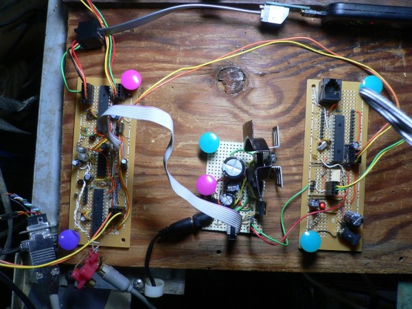

The second voice engine dsPIC has been added and wired up. It is currently running a data reliability test with SPI. The SPI (sent from the MIDI controller in master mode) now drives 2 devices and has run for more than 24 hours with no errors. The test sends 32 bit messages, the first 16 bits is a pseudorandom word from an LFSR. The second word is the inversion of the first word. The receiver inverts one word and then compares the two. If the same, the data is considered good.
I've also recently added support for the sustain pedal to the MIDI controller.
Currently, I am working on bringing the synth up to 8 voices. _________________ FPGA, dsPIC and Fatman Synth Stuff

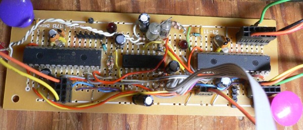

I've added a second dsPIC voice engine, done a bit of troubleshooting and now I have an 8 voice DSP harp polysynth using 3 dsPICs. One is a MIDI controller and voice assigner and the other two are 4 string harp voice engines.
The sample provided is a MIDI sequence playing into the harp and I'm noodling the two knobs. The sample is completely dry.
You'll notice around 3:17 it starts to go really flat. That's a consequence of the karplus-strong model. I may throw in a display... - if I did I give it selectable tuning tables.

Description: |
Filesize: |
229.16 KB |
Viewed: |
393 Time(s) |
Description: |
Harpie Voice Engines Board |
Filesize: |
140.18 KB |
Viewed: |
378 Time(s) |
