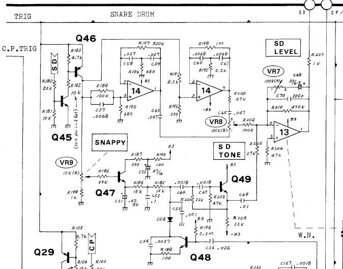

thank you very much for the confirmation! I'm going to have a look at the original schematics in a moment. If I recall, the 2N3704 has one pin unconnected as it is the noise source. I'll double check this. In the meantime if you could let me know where I've gone wrong I will correct the images and BOM. Once again thanks! I'm glad it worked for you. I'll check out the Ken Stone circuit...

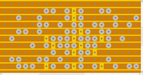

Yeah, the collector on the 2n3704 -middle pin- is unconnected, and the emitter connects to R39 instead. Not a big thing really... I havn't tried but I bet you could put any NPN transistor in there and it would work.
Let's see, C1 is 6n8, as is C5, C25 should read 47uF.
The CGS gate-to-trigger is worth the half opamp, ten components and 11x11 piece of stripboard it takes to make. That said, I had all the parts to hand, but it does the job of triggering cleanly from practically anything, and I've put one in every percussion module I've made.

Can't believe I made SO MANY mistakes!! Embarassed I'll fix up the illustrations shortly and replace them and make a note on them that they have been corrected!
I'm was just looking at Eric Archers schematic he posted and it looked initially like the middle pin of the 2N3704 transistor was connected... BUT actually, I believe you are right here again!! I used a PN100 as a replacement for the 2N3704.
OK, so I have a bit of fixing up to do. My soldered board has all of the faults you have found! INCLUDING C25!!! Time to heat up the iron and pull out some components.
Once again: THANKS HEAPS for your help!!

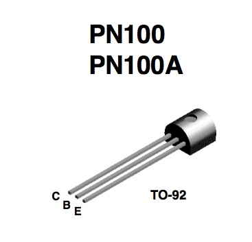

um.... isn't the middle pin the base? Looking legs down with the flat side facing you, I thought it was left to right EMITTER, BASE, COLLECTOR. Hold on, I'll check for a data sheet..... scratch

OK... getting there! Here's the pin layout for the 2N3704 and the PN100 transistors. Note the difference! I may have to post two different layouts for the two different transistors.

It looks as if the layout at present is correct for the PN100 but NOT for the 2N3704. I'll triple check this though.... I'll amend the component list accordingly and change the values of C1 to 6n8 and C25 to 47uF.
I should probably post a separate version for the 2N3704...

Just fixed up the component list. The layout is the one where the PN100 is used rather than the 2N3704. Yet to try the gate to trigger circuit, but I shall breadboard it shortly and see if it rectifies the triggering issue. It sounds OK triggering from rail 21, hole 38... but I should see if I can get it happening from the correct point.
Hmmm.... and I should fix up the pot wiring as some of the pots are wired in reverse! I can never seem to get that right! My toast always falls buttered side down...

I prepped and mostly populated a stripboard for one of these over the last two days, the very clear artwork made the job pretty simple. Multiple thumbs up for the great job. As soon as I receive the couple resistors and caps that weren't in my stock I'll get it done.
I also went ahead and laid out striboard for a double CGS24, gate-to-trigger converter. (Couldn't believe I had a piece of cutoff from another project that was exactly the right size... what are the odds, huh? Wink ) Seeing as how they're so small & simple I'll probably do several more
I figured these would be excellent additions to my percussion cabinet... so far I've got Thomas Henry's MPS and his quad Bass++ boards, now this and a Liquid Hi-Hat and I should be pretty well setup. I suspect, though, that there will be other additions along the way, this DIY stuff is pretty addictive. Exciting stuff... thanks so much for sharing.

Here is the stripboard for the double CGS24 module.

PostPosted: Wed Aug 10, 2016 3:29 am    Post subject: Reply with quote  Mark this post and the followings unread
It seems there were some last minute changes made to the schematic, which are mentioned in the TR-808 Service Manual, but have not been implemented in this layout...
